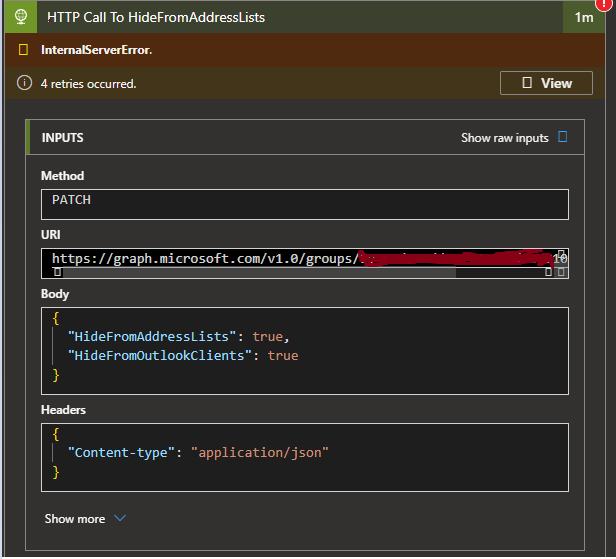

After January 15 request to update groups properties hideFromAddressLists or hideFromOutlookClients ends up with error response: ErrorInternalServerError Message: An internal server error occurred. The operation failed., The value is set to empty Parameter name: tenantId. Tried for v1.0 and beta endpoints UPDATE: started working again on 27.01.2025

    On 27.01.2025 can confirm that is started working again

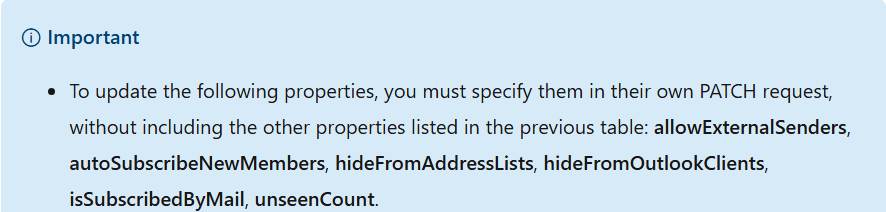

    Apologies for the inconvenience caused. Regarding the error "ErrorInternalServerError Message: An internal server error occurred. The operation failed., The value is set to empty Parameter name: tenantId", we tried replicating the issue and below are the results for the same. Make sure you are updating only the mentioned properties (hideFromOutlookClients and hideFromAddressLists) while working with PATCH requests by excluding other properties as mentioned in the official documentation.
    Screenshot of Replication: patch group props test
    Make sure the content-type header is set to application/json in your API request.
    Test the API in Graph Explorer once and let us know if the issue still persists.
