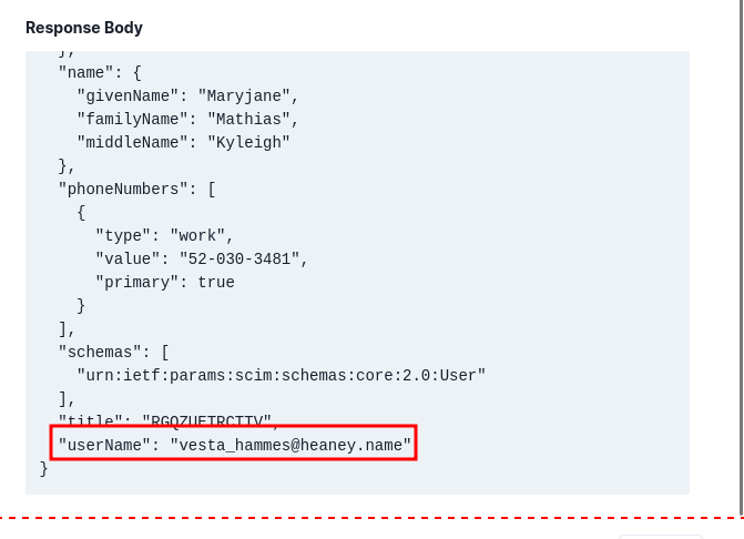

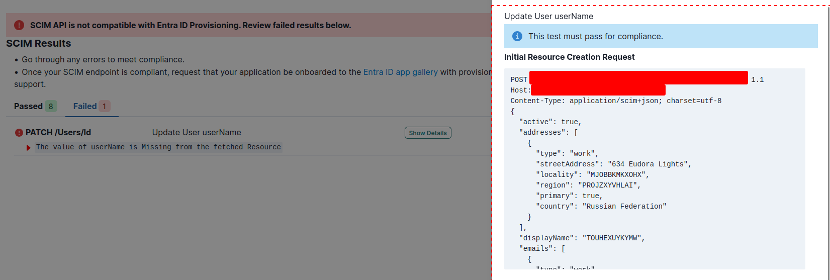

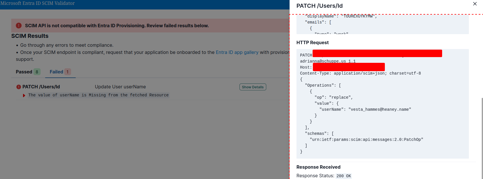

Hi everyone, I'm working on implementing a SCIM 2.0 endpoint for updating users with a PATCH request (PATCH /Users/Id), and I've encountered the following error:
2025-01-23_11-16
2025-01-23_11-17
and my response 2025-01-23_11-17_1
I don't understand the error because userName is in my response, add Json
	"addresses"
							"type"
							"streetAddress"
							"locality"
							"region"
							"country"
							"primary"
	"displayName"
	"emails"
			"value"
			"type"
			"primary"
	"externalId"
	"id"
	"meta"
		"resourceType"
		"created"
		"lastModified"
	"name"
		"givenName"
		"familyName"
		"middleName"
	"phoneNumbers"
			"type"
			"value"
			"primary"
	"schemas"
		"urn:ietf:params:scim:schemas:core:2.0:User"
	"title"
	"userName"
Any guidance or suggestions would be greatly appreciated. Thanks in advance!

    Based on your issue description, I understand that you are working on implementing a SCIM 2.0 endpoint for updating users with a PATCH request (PATCH /Users/Id), and you have encountered the following error: SCIM API is not compatible with Entra ID provisioning. Review failed results below.
    The SCIM validator is complaining that:
    The value of userName is Missing from the fetched Resource.
    Based on the error what you are getting, I would advise you to submit the update request for your gallery application. You can work through why the validator is failing on those tests - and if it's due to something on your end or on the validator's end - after submitting, as you'll be on an email thread with the product team that manages the validator.
