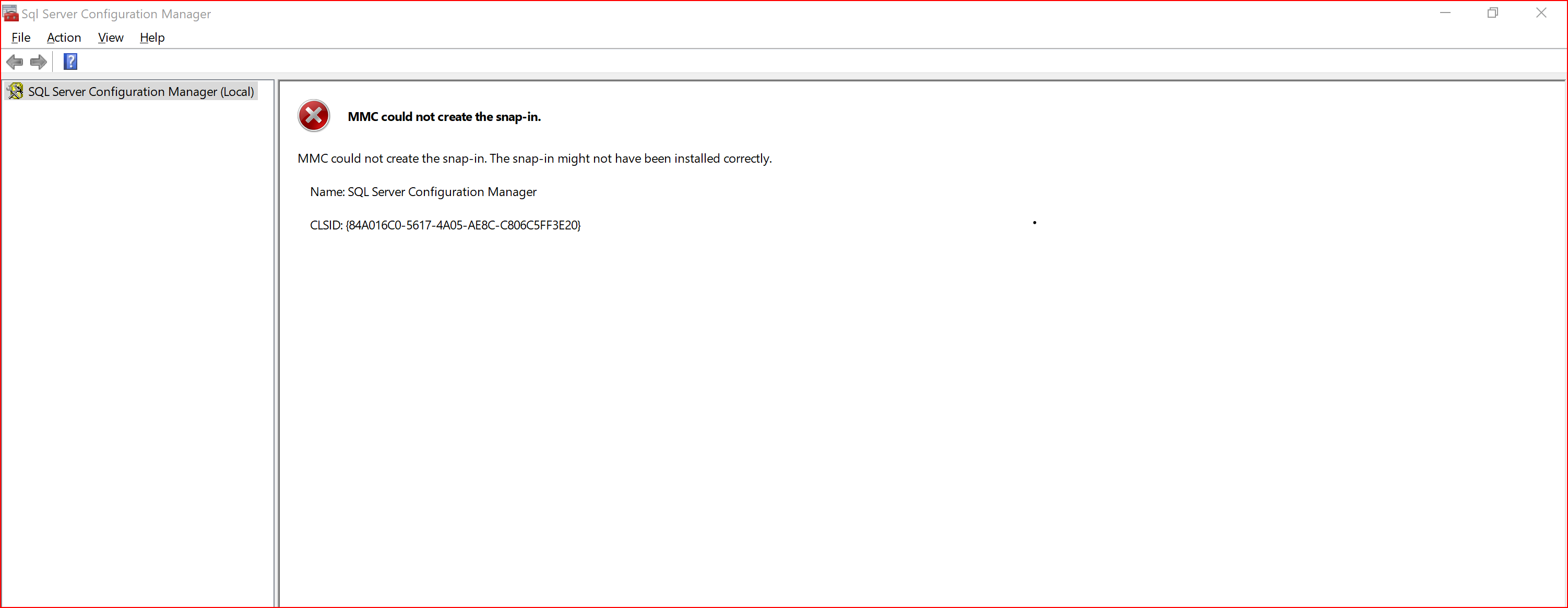

I used SQL last year for sometime just fine, then recently this month tried getting back to it & suddenly it doesn't work. I might have deleted some files by accident so I uninstalled everything SQL related & installed again. Still not connecting to the server. And now even the SQL configuration manager doesn't show the statuses, showing "couldn't create snap-in" error.
When I'm trying to connect to the server it takes a while then says cannot connect to SQL Server due to network-related or instance-specific issue & that the system couldn't find the file specified, even though the reinstallation was 100% succesfully completed & I just used all default options with no customization.
I have attached 2 screenshots of the errors showing on each tool.sql error
sql error 2
I would really appreciate help possible as I need this for my job. Thank you so much!
I have also attached an error log below as further reference:

  1. LiHongMSFT-4306 31,616 Reputation points
    2025-01-26T01:15:42.4666667+00:00
    Hi @Karim El Kadri
    Regarding this connect issue, it is suggested to troubleshoot follow by this tech doc: Network-related or instance-specific error.
    Best regards,
    Cosmog
