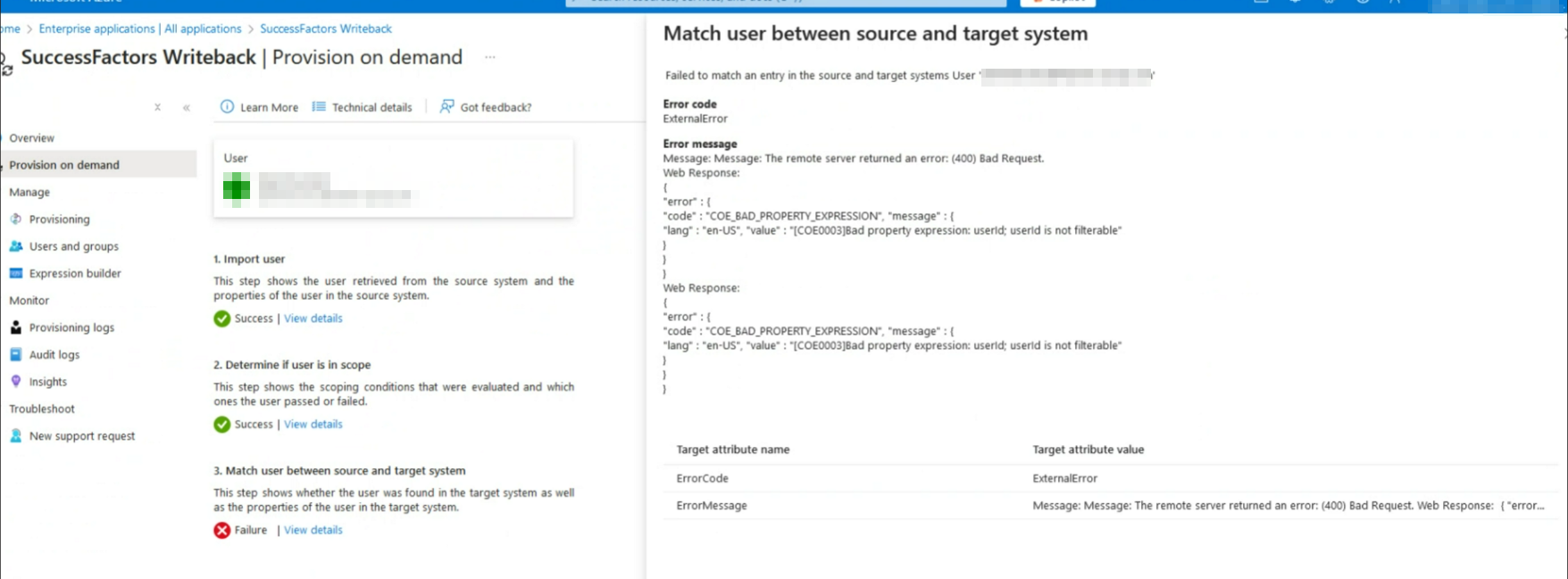

We then moved the configuration to the PRODUCTIVE Entra environment and connected to the SuccessFactors PROD tenant, where we receive the following error message:

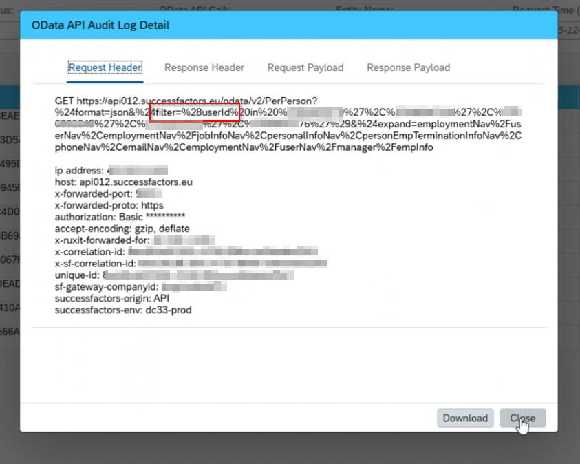

Checking the OData Audit Log on SF side, we can see the service is trying to use the SF userId in the $filter. However, the userId like this is truely not filterable. The path should be $filter=userNav/userId, as it is checking the wrong entity.
Strangely in the Development Environment the exact same Service is using SF personIdExternal in the filter - which is working without any issue.

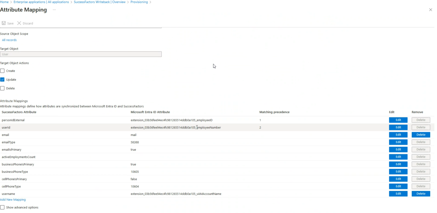

Here's the mapping:
Switching the matching precedence didn't change anything.
