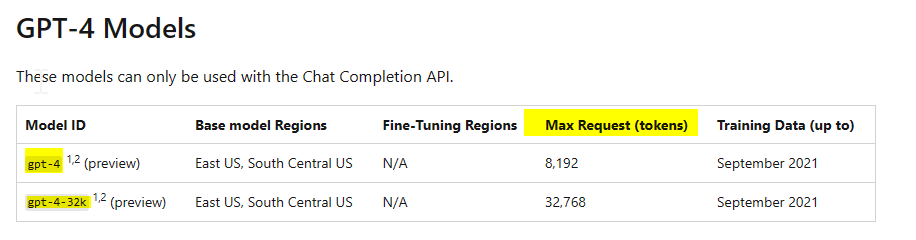

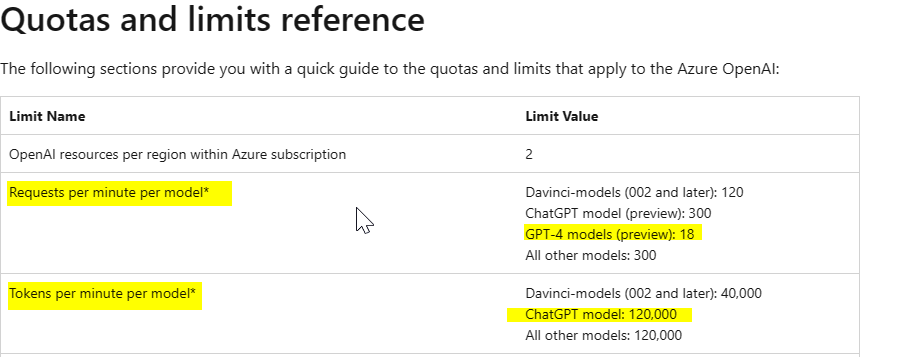

  1. Ketsha 325 Reputation points Microsoft Employee
    2025-02-12T17:13:08.14+00:00
    Hi - Please use the following table and refer to the link below since this will help with the Quotas and limits that you are hitting.
    enter image description here
    Here is the quota and limits information: https://learn.microsoft.com/en-us/azure/cognitive-services/openai/quotas-limits#quotas-and-limits-reference
    Also, GPT-4 model details: https://learn.microsoft.com/en-us/azure/cognitive-services/openai/concepts/models#gpt-4-models
