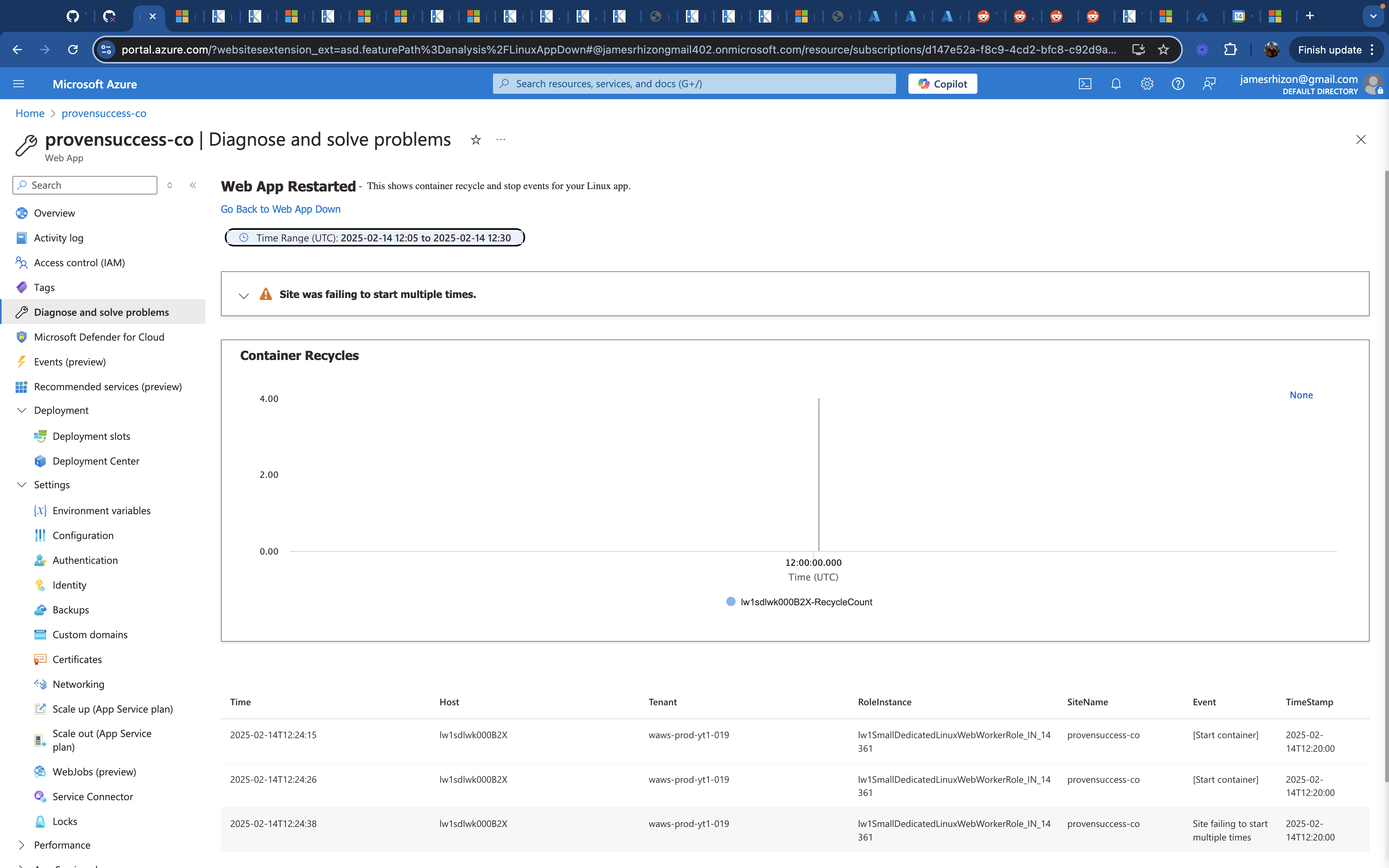

    2025-02-14T03:06:06.928Z ERROR - Container provensuccess-co_0_4fdc3f8f for site provensuccess-co has exited, failing site start
    2025-02-14T03:06:06.940Z ERROR - Container provensuccess-co_0_4fdc3f8f didn't respond to HTTP pings on port: 8080, failing site start. See container logs for debugging.
    2025-02-14T03:06:07.017Z INFO  - Stopping site provensuccess-co because it failed during startup.

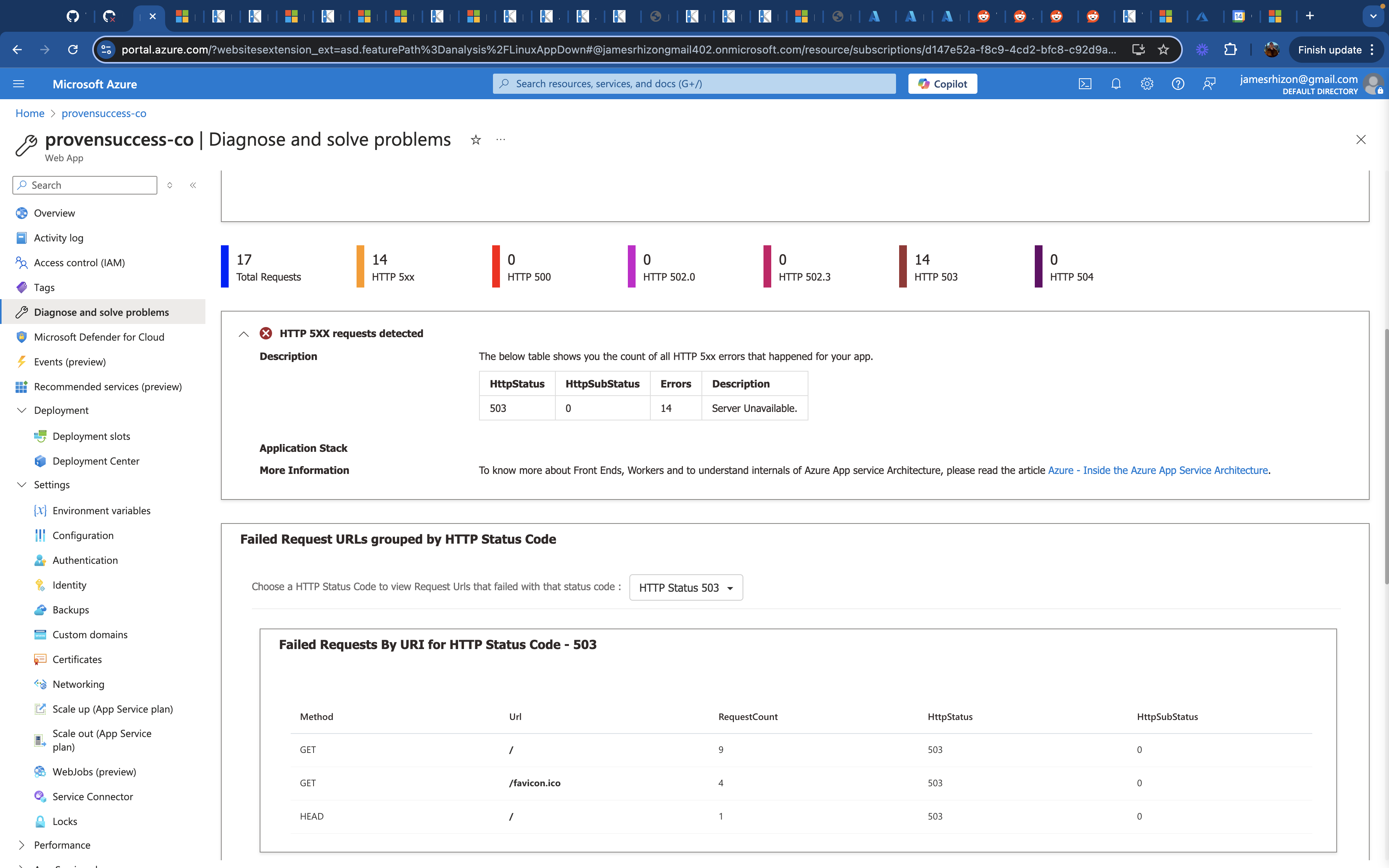

    I've been continually trying to ensure that we do in fact communicate with port:8080 with adding to startup command like this:
    PORT=8080 npm run start --prefix /home/site/wwwroot
    ...or, adding this Dockerfile:
