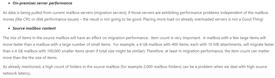

    After research, I found an explanation about this issue in: Troubleshooting Slow Migrations
    StalledDueToTarget_MdbAvailability: the move monitors replay queue of transactions logs into remote copies of databases. Migration stalls when the queue gets too big and will last until it drains.
    This article is about Exchange Online Migration, but it also has some things in common with on-premise Exchange. We may pay attention to these parts mentioned in this article:
    To eliminate these possible causes, I recommend you to move a new mailbox by using the New-MoveRequest, and specify a new database as the target.
