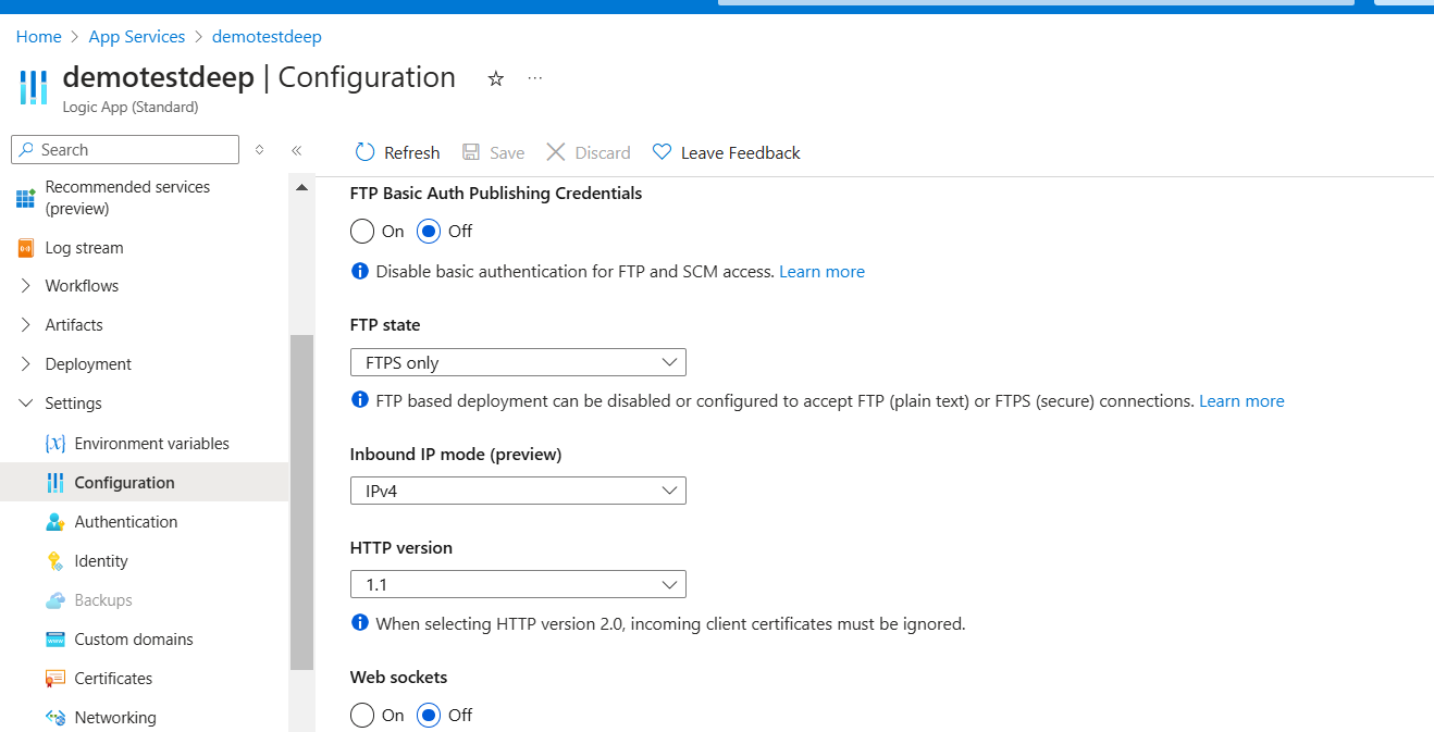

    To enable the WebSocket protocol in your Azure App Service, follow these steps:
    Access the Azure Portal: Navigate to the Azure portal and locate your App Service.
    Go to Configuration: In the App Service menu, select the "Configuration" option.
    Enable WebSocket: Under the "General settings" tab, find the "WebSocket" option and ensure it is set to "On".
    This setting allows your App Service to support WebSocket connections. Make sure your application is also configured to handle WebSocket connections properly. If you need further assistance, refer to the Azure documentation on WebSocket support.
