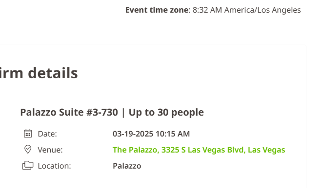

When I try to Add to Calendar from a third party app for meeting scheduling (SimplyBookMe), it is not translating the time zone correctly when I open up the calendar invite in Outlook. This is specifically surrounding dates around Daylight Savings Time. For example, I will book for 8AM Pacific Time and it will translate to 10AM Mountain Time which is incorrect (it's only a 1 hour time difference). Is there coding on the third party app that I should be checking to make sure SimplyBookMe and Outlook are communicating correctly?
Here are some screenshots to show the issue. As you can see, the tool is set to America/Los Angeles time zone (Pacific Time) and I have booked a time slot for 10:15AM PT.

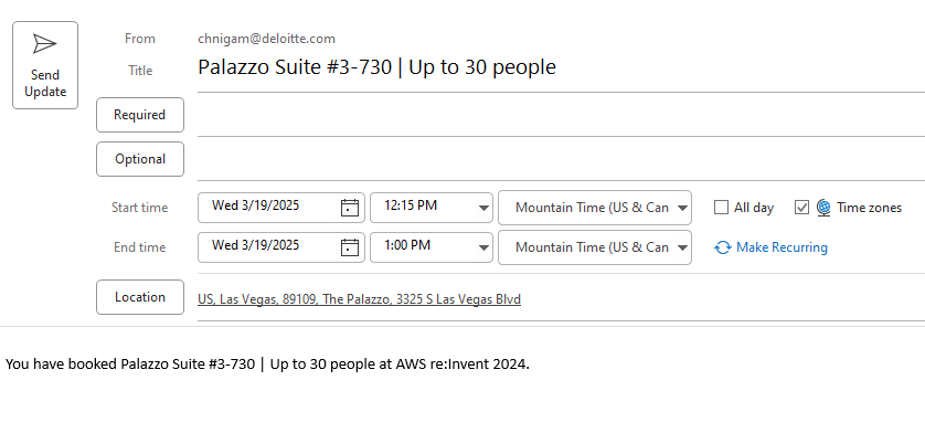

I am currently in Mountain Time. When I click the Add to Calendar button, and Outlook, it downloads a calendar invite that is adding 2 hours to the time (and should be 1). This is where I am seeing the issue. It is adding an extra hour of time to the booking. I've had colleagues test it in CT and ET and the same issue happens where it is off by an hour.

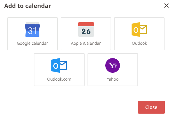

The meeting is booked through the tool SimplyBookMe, which once you book it, it has an "Add to Calendar" button. I select Outlook, which then downloads a calendar invite. Once I open it up, that is where I am seeing the issue that the time zone has not translated correctly.

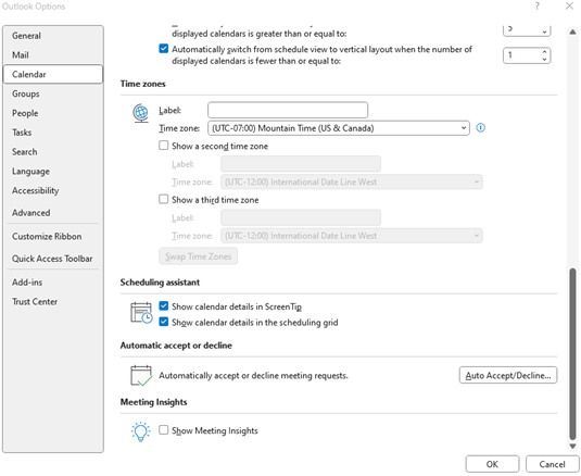

The timezone settings in my Outlook is Mountain Time.
I am using Microsoft 365 apps for enterprise.
