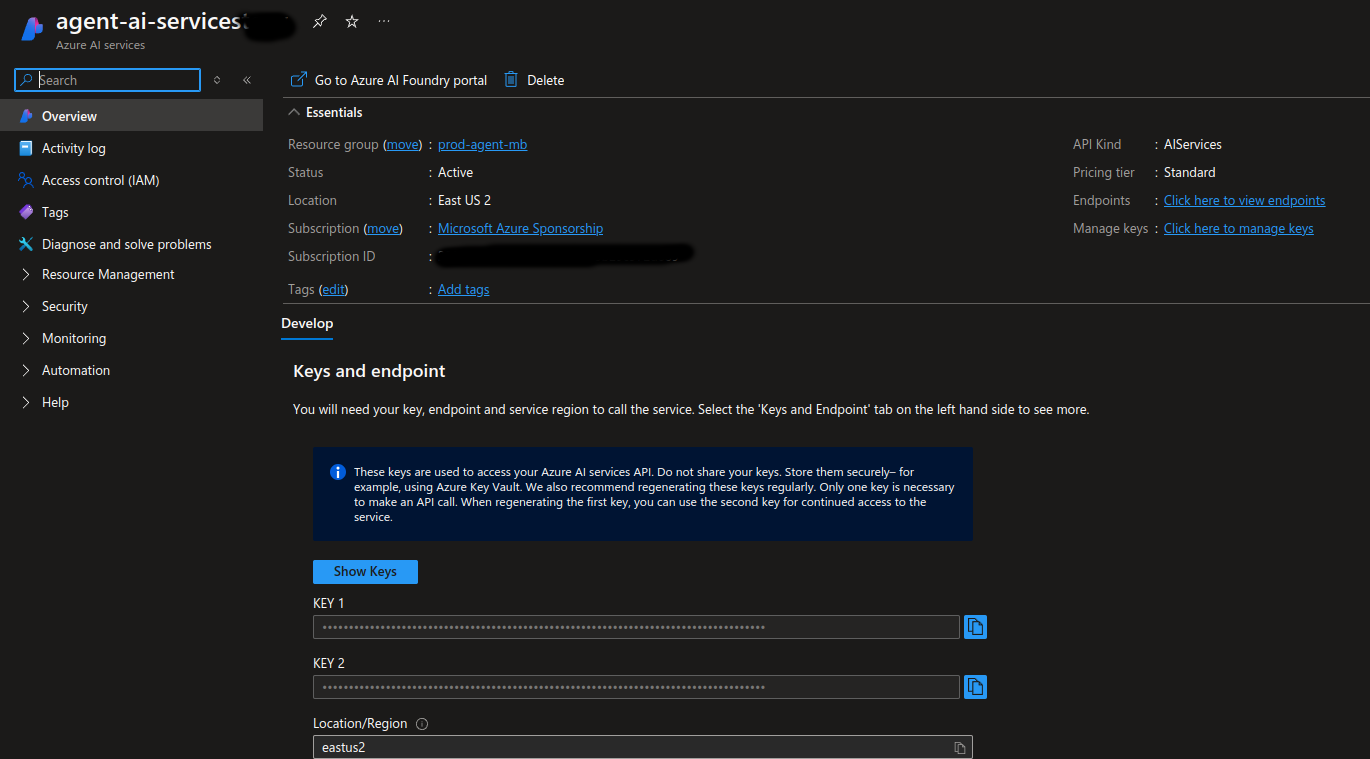

I used the basic template at the agent quickstart page, set the project to work with API keys and then picked up the keys from my agent-ai-service inside of my Resource Group.
Screenshot from 2025-02-18 09-19-37

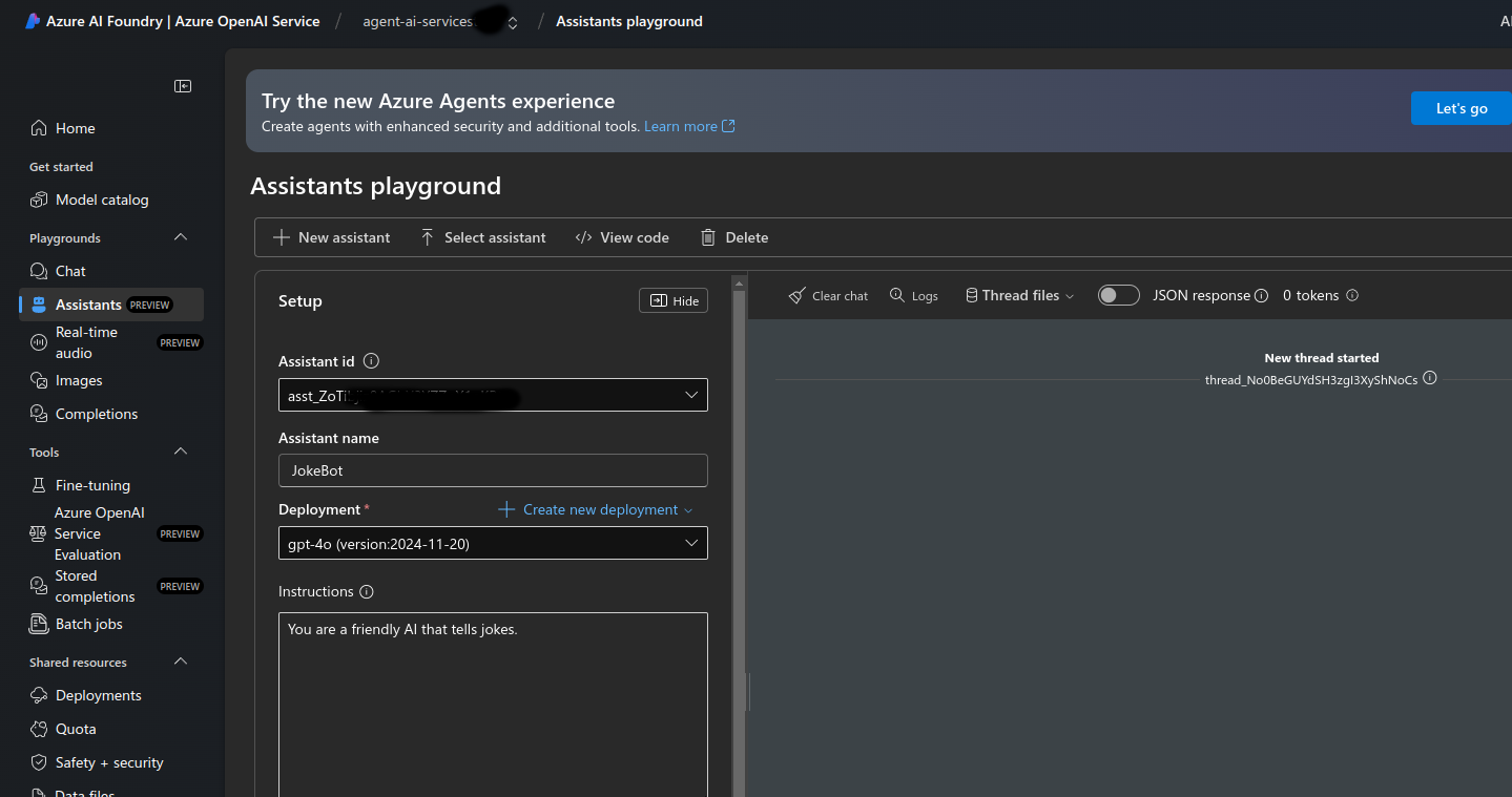

But what I end up getting isn't an Agent at all, I end up creating an Assistant and the page where I land even suggests creating the new Agents instead.
01
