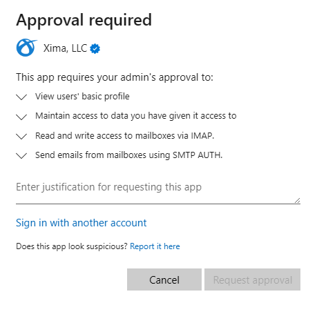

Hello,
One of our enterprise clients on Microsoft is trying to do the OAuth flow for our application ID but is facing an approval wall.
The user is prompted with the window 'Approval required'. They fill in the 'Enter justification for requesting this app' and click 'Request approval'. It goes to their Microsoft 365 admin who approves it (they have done it a dozen times already), but the user can still not log in.
On the other hand, when an admin tries to log in, they have the option 'Consent on behalf of your organization' and can then connect successfully. But the normal user still nothing, they keep having the Microsoft 'Approval Required' form.
Our application is requesting the following scopes: [ 'offline_access', 'openid', 'profile', 'EWS.AccessAsUser.All', 'Mail.ReadWrite', 'Mail.Send', ]
We are making the OAuth process via the URL https://login.microsoftonline.com/common/oauth2/v2.0/authorize?prompt=consent
We use ?prompt=consent as described here: https://learn.microsoft.com/en-us/entra/identity-platform/howto-convert-app-to-be-multi-tenant#admin-consent
In "App Registrations > Manage > Authentication" on Azure Portal we have selected "Accounts in any organizational directory (Any Microsoft Entra ID tenant - Multitenant)".
Could you be guide us into what is the issue leading our user not being able to log in? It is not the only one who has this issue (already the fourth one). It is very frustrating.

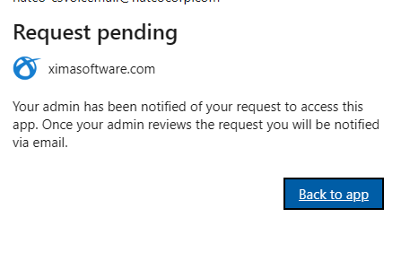

    I have this same problem. I have been tasked with making this admin consent flow to work in my app. I have seen the option to use the link for the admin to give consent for everyone but we have some security conscious customers that don't want to do that. https://login.microsoftonline.com/{tenant_id}/adminconsent?client_id={client_id}My customer gets logged in and sees this screen. User's image
    They enter the justification and click request approval. User's image
    Then the user clicks the "Back to app". When they are redirected back to my app I get this request. https://my-app.com/oauth/authorized?error=access_denied&error_subcode=cancel&state={state}d&error_description=AADSTS65004%3a+User+declined+to+consent+to+access+the+app.
    As far as my app knows they declined consent. But the email gets sent to the admin. They approve the consent, then the user gets an email saying the admin gave consent.
    How do I continue from here and finish this flow after consent is given?
