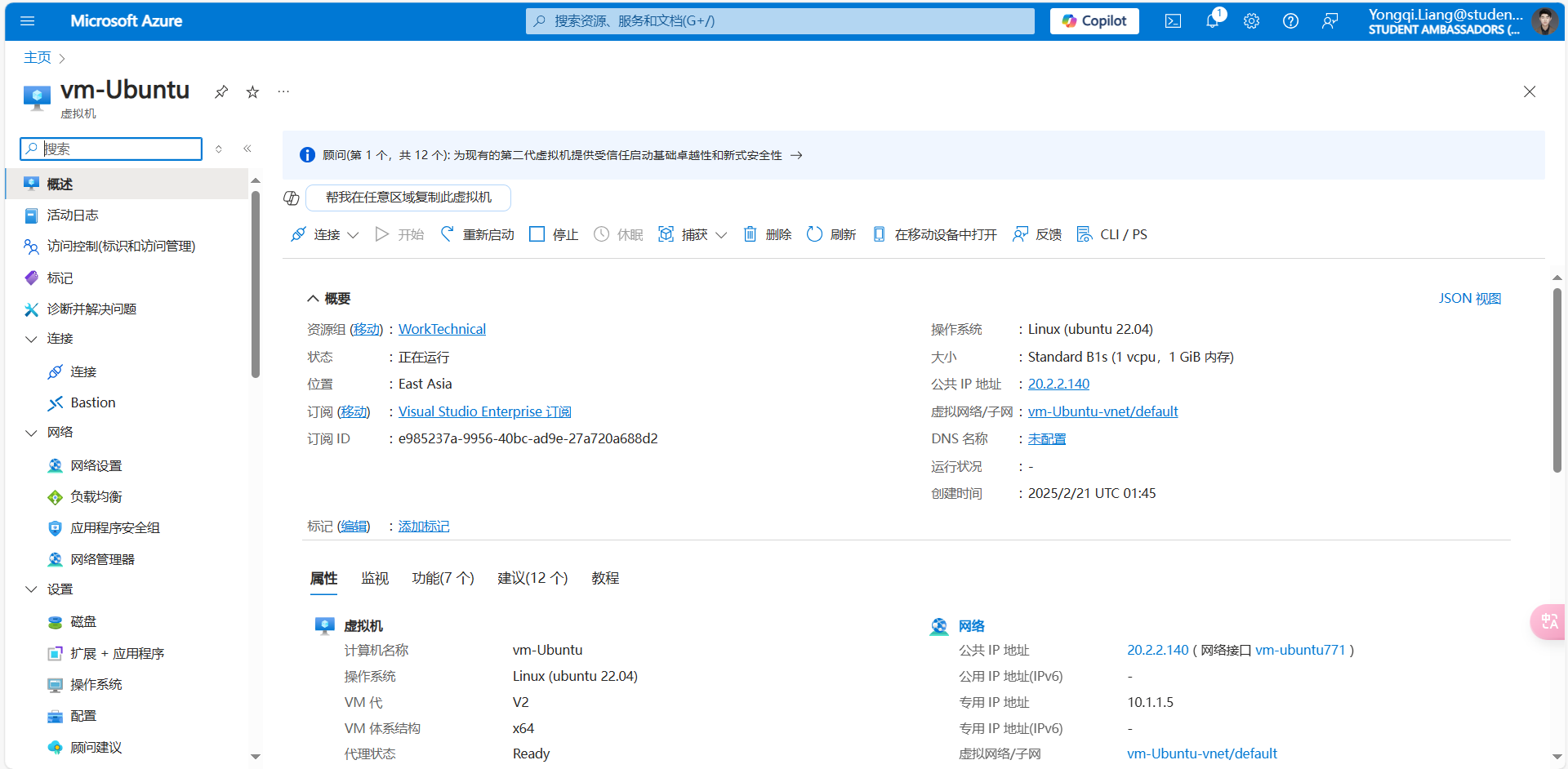

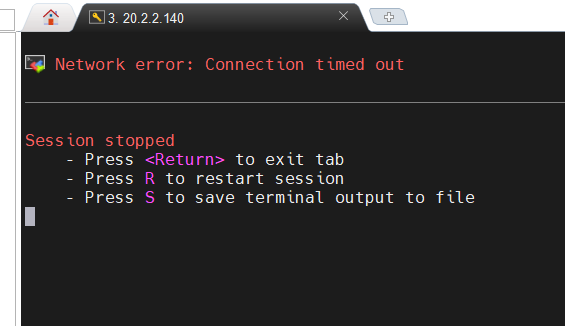

my azure vm cannot connect, i try to ping the vm's public ip but not receive response.

    The VM is not responding to SSH and ping requests. So it is possible the VM is stopped or having network issues. From your screenshot I can see the VM is started. But let's got through the process:
    • Go to Azure Portal > Virtual machibnes and click yout VM
    • On the Overview page if status is “Running”, your VM is active.

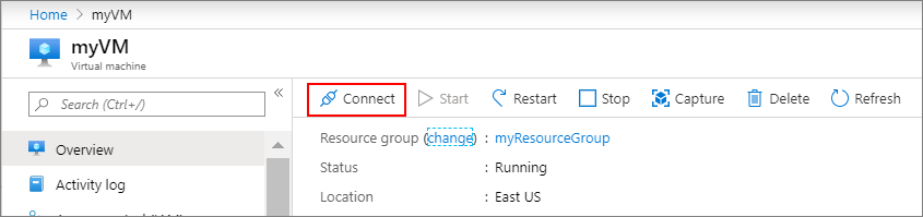

    If the Vm is started the start button will be greyed out and you can try to connect:
    Also If your VM was restarted, the public IP might have changed, you can copy the IP and try to connect. Ping is disabled by default on azure VM so your ping resultl may not be accourate
    Try and connect using:
    Screenshot of the virtual machine overview page showing the location of the connect button.
