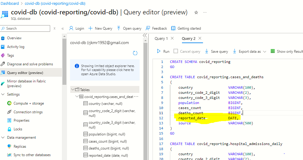

I have uploaded the resources file into the Azure SQL server and created the tables in the database. In the "covid_reporting.cases_and_deaths" the column name is mentioned correctly. Here is the screenshot below.created table
Don't know why the pipeline is not debugging.

    The error SqlColumnNameNotExist occurs because the column reported_data does not exist in the target table covid_reporting.cases_and_deaths. Based on your table schema, the correct column name is reported_date.

    The column name in sink is reported_date whereas the error is for column : reported_data
    Check the mapping in the copy data activity
