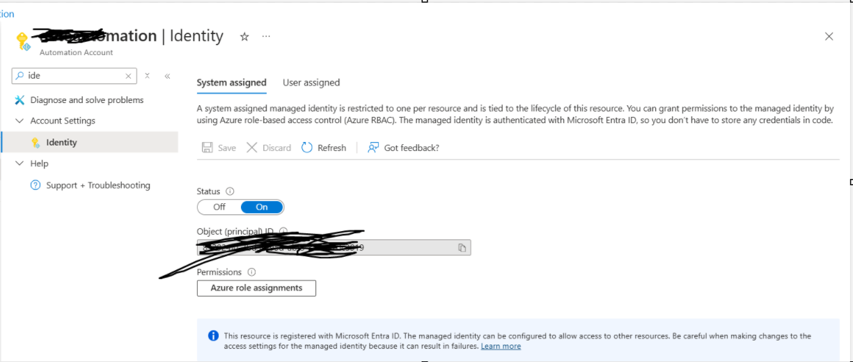

    Please follow the instructions below for this to work. Add the two lines to the runbook as mentioned. I see you have enabled the managed identity, so I'm providing a step-by-step process for clarity.
    1. Please enable managed identity of your automation account keep it on User's image

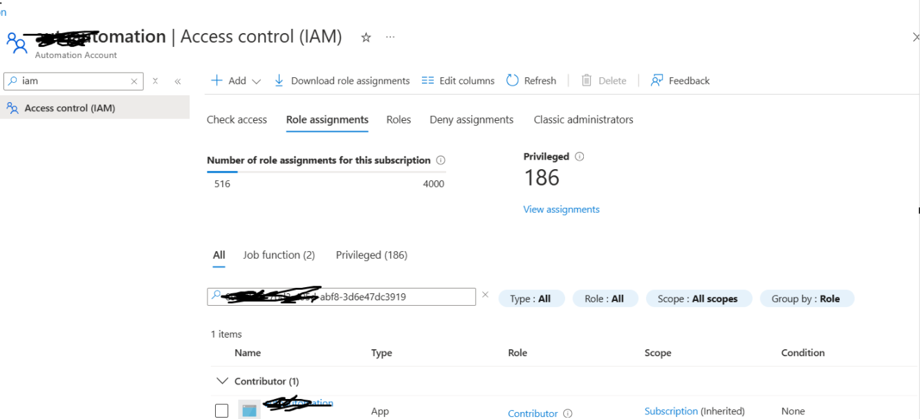

    2. Once you have enabled provide this managed identity copy paste the identity in IAM and provide that identity with contributor access find the below screenshot, please provide it to the appropriate managed identity User's image

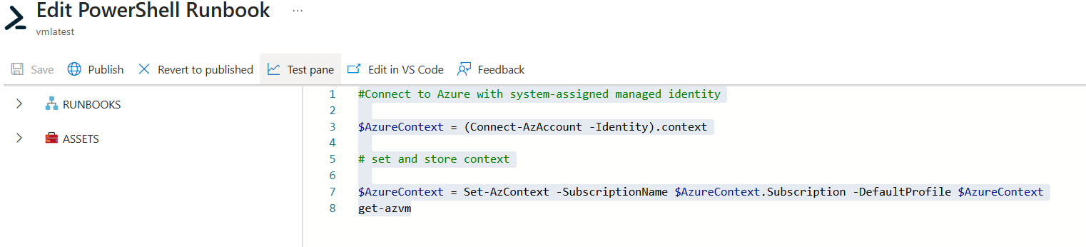

    3. Please add the below script before you run any commands Azure PowerShell Copy
    Please add these 2 lines to your runbook.
    #Connect to Azure with system-assigned managed identity
    $AzureContext = (Connect-AzAccount -Identity).context
    # set and store context
    $AzureContext = Set-AzContext -SubscriptionName $AzureContext.Subscription -DefaultProfile $AzureContext

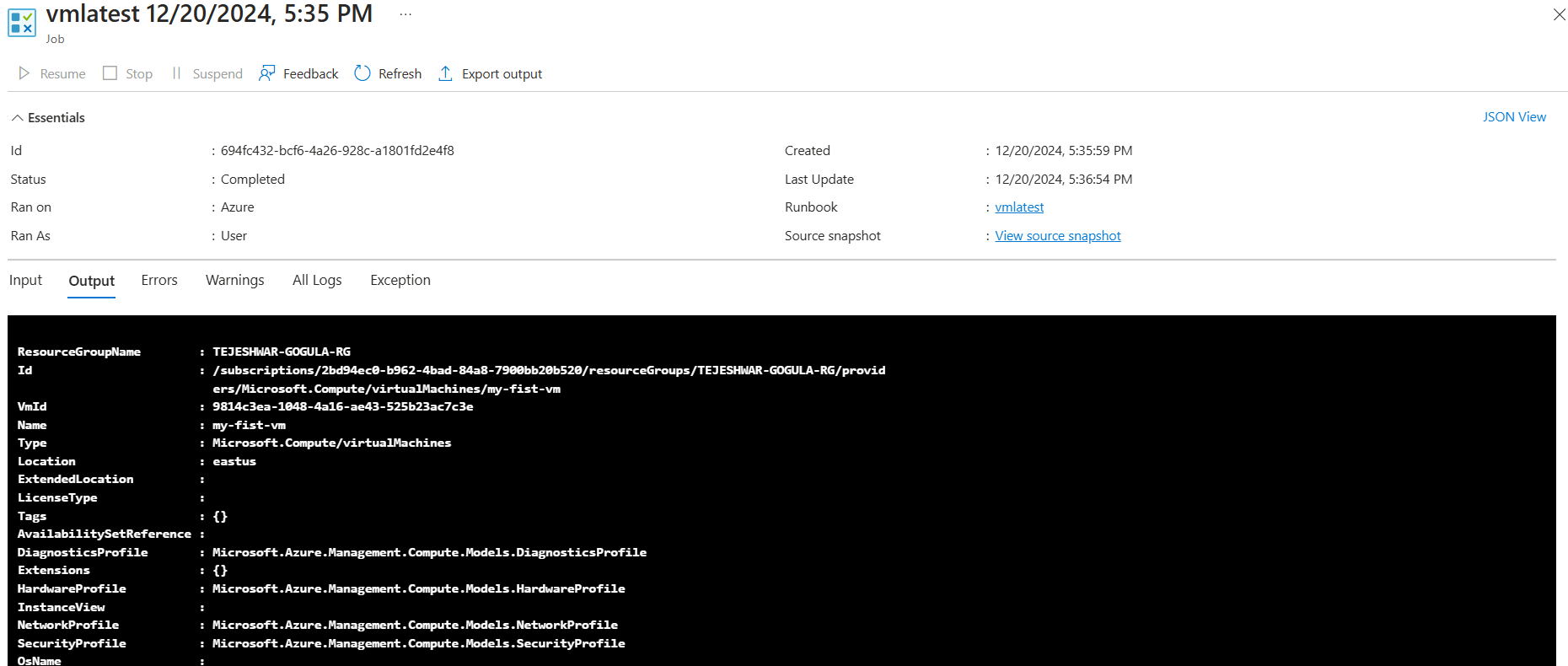

    My example i have used get-azvm you can use whatever the commands you want to, please find the below output screenshot for azvm
    let us know if you have any further queries. I’m happy to assist you further.
