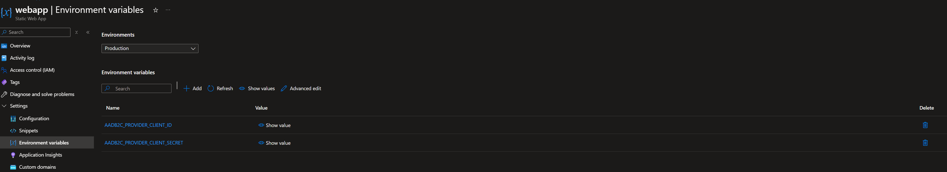

Things I have tried in addition to the inclusion of the variables above (and association with the Azure SWA through the setting (manually) of the associated Environmental Variables):

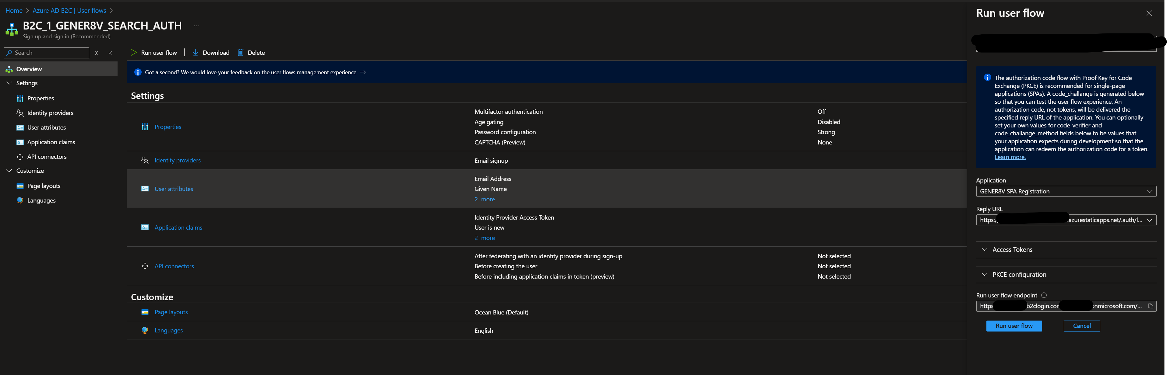

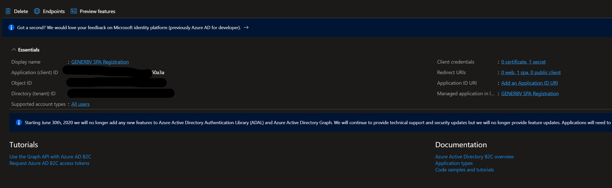

I've also tried numerous iterations of configuring the Azure AD B2C tenant, the associated Application Registrations, and the subsequent User Flows (which do work).

The Application Registration
The associated User FlowUser's image
The Static Web App
