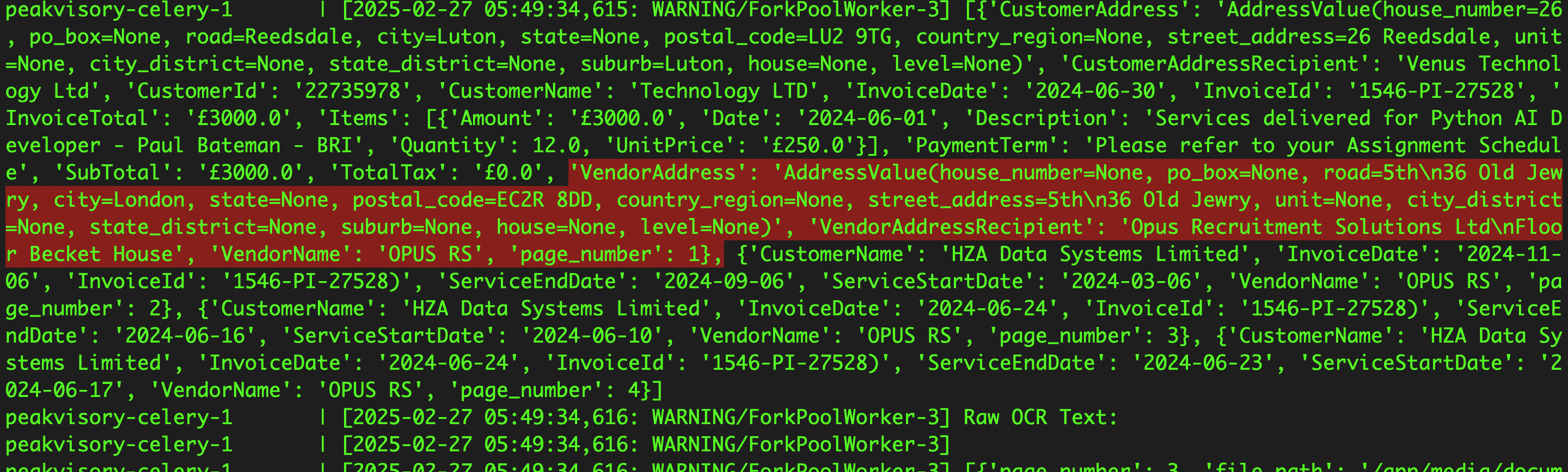

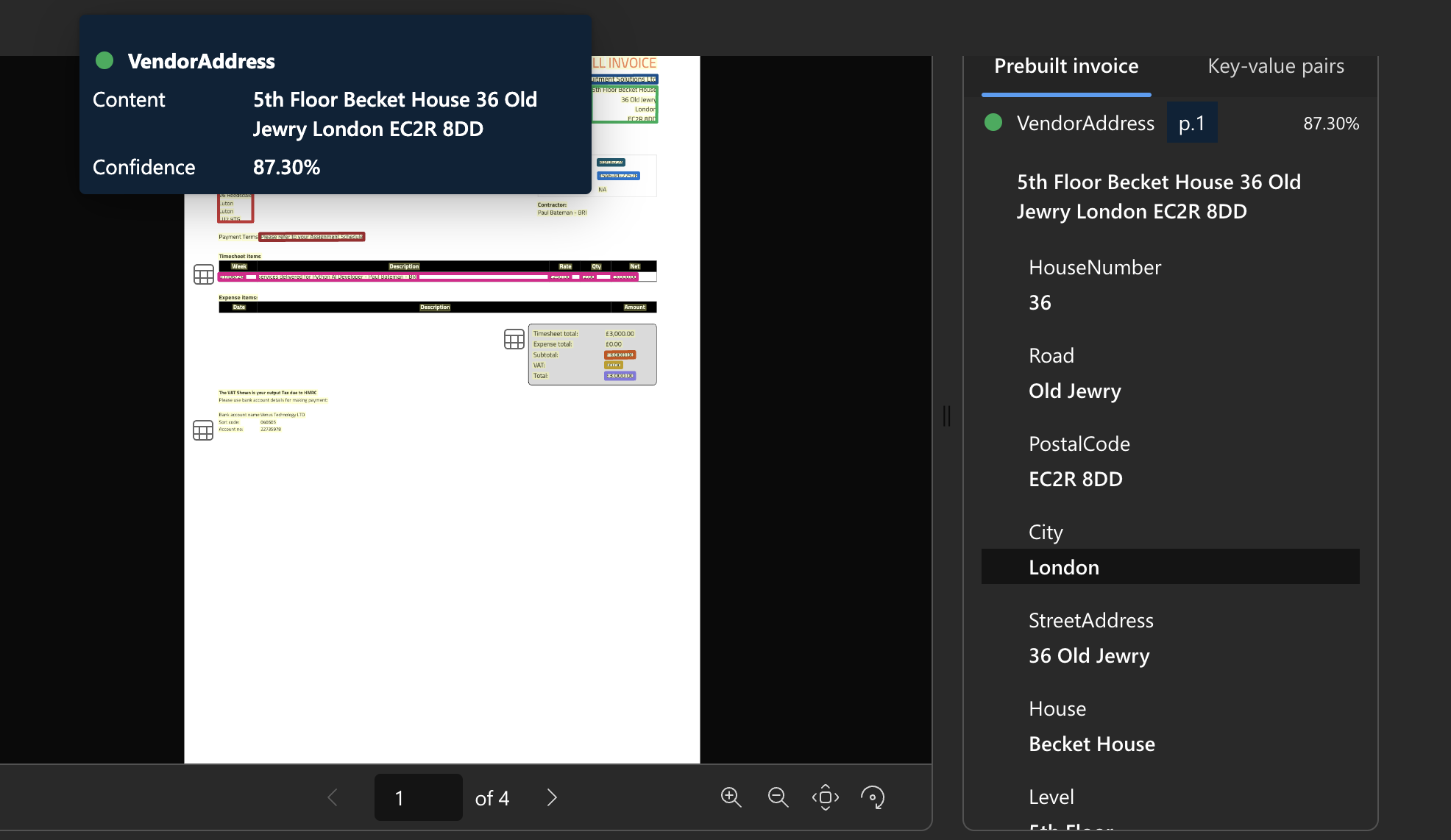

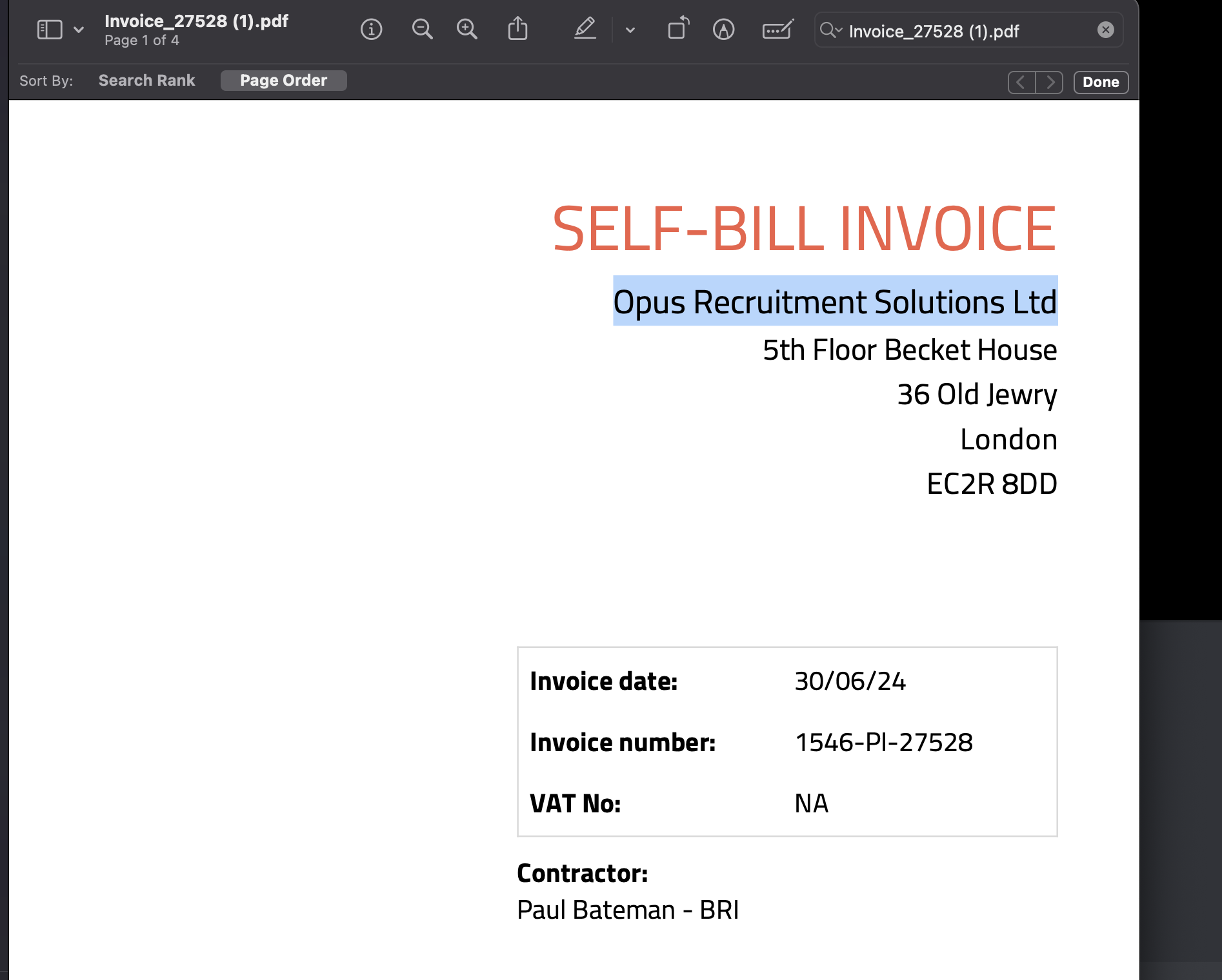

For Some invoice i did not get exact vendor address or info in api even it is shown in visualizer
Kunal 0 Reputation points
2025-02-27T11:17:31.4233333+00:00
The invoice I uploaded is retrieving incorrect data from the code, even though it appears correct in the visualizer. Could you help me identify what might be causing this issue and suggest possible solutions?
I am attaching screenshots and doc for your reference.
