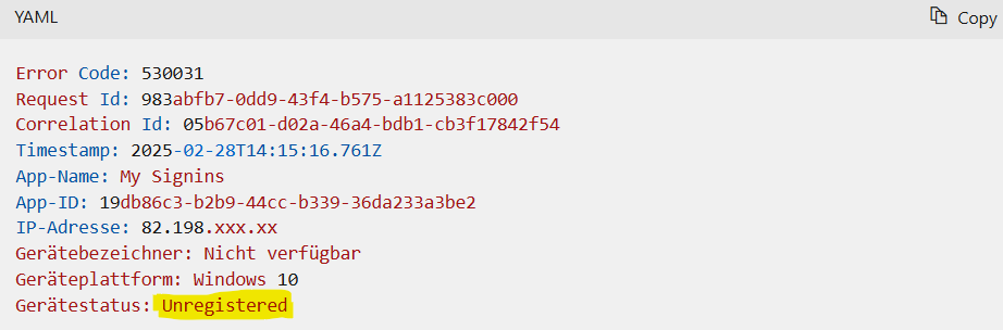

User A has a new domain joined device. He isn´t able to login to office.com or anywhere else, because of "Error Code: 530031".
Details from clipboard below:
Error Code: 530031
Request Id: 983abfb7-0dd9-43f4-b575-a1125383c000
Correlation Id: 05b67c01-d02a-46a4-bdb1-cb3f17842f54
Timestamp: 2025-02-28T14:15:16.761Z
App-Name: My Signins
App-ID: 19db86c3-b2b9-44cc-b339-36da233a3be2
IP-Adresse: 82.198.xxx.xx
Gerätebezeichner: Nicht verfügbar
Geräteplattform: Windows 10
Gerätestatus: Unregistered
Researches and the mentioned solutions did not help to solve this problem.

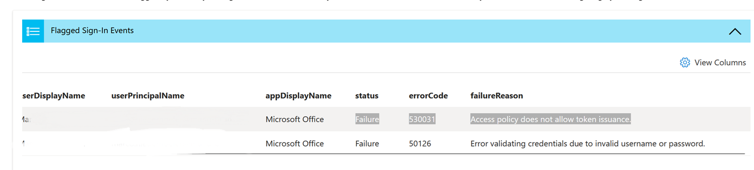

I checked the azure login logs for this specific user and the failure reason is: "Access policy does not allow token issuance"
There is no access policy configured. Just two conditional access policies.
  • When users in the 'Group A' group sign-in: They are required be on an Intune compliant or domain-joined device
  • When any user is outside the company network: They're required to sign in with multifactor authentication
User A is Member of Group A.

    The error is being caused by a Conditional Access policy that is blocking access token issuance due to a matching policy.
    Upon reviewing the Conditional Access policies applied to Group A, I see that users in this group are required to sign in from either an Intune-compliant device or a domain-joined device.
    Since User A's device is unregistered, it is not being recognized as compliant or domain-joined, which is why the Conditional Access policy is preventing token issuance and blocking sign-in.
    To resolve this issue, please ensure the device is properly registered with Microsoft Entra ID. Depending on whether this is a personal or work device, the following guidance will assist in verifying and completing the registration process:
