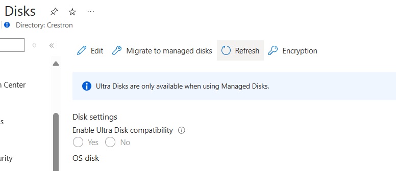

I understand the process of migrating VM with unmanaged OS disk is by clicking to "Migrate to managed disk" button in the disk console. However, If there is an additional data disk, will this process convert it as well? If not, how do you handle non-OS unmanaged data disk conversions to managed disks?unmanaged_disk_migration

As per https://learn.microsoft.com/en-us/azure/virtual-machines/windows/convert-unmanaged-to-managed-disks , this process converts both the OS disk and data disks to managed.
"If you have existing Windows virtual machines (VMs) that use unmanaged disks, you can migrate the VMs to use managed disks through the Azure Managed Disks service. This process converts both the operating system (OS) disk and any attached data disks."

  1. SUNOJ KUMAR YELURU 18,336 Reputation points MVP Volunteer Moderator
    2025-03-02T03:17:11.59+00:00
    Hello @Scion
    Migrate using the Azure portal
    You can also migrate unmanaged disks to managed disks using the Azure portal.
    1. Sign in to the Azure portal.
    2. Select the VM from the list of VMs in the portal.
    3. In the blade for the VM, select Disks from the menu.
    4. At the top of the Disks blade, select Migrate to managed disks.
    5. If your VM is in an availability set, there will be a warning on the Migrate to managed disks blade that you need to migrate the availability set first. The warning should have a link you can click to migrate the availability set. Once the availability set is converted or if your VM is not in an availability set, click Migrate to start the process of migrating your disks to managed disks.
    The VM will be stopped and restarted after migration is complete.
    • Downtime: The conversion process requires downtime because the VM must be stopped and deallocated. Plan accordingly.
    • Backup: It's always a good practice to back up your data before performing any major changes like this. Consider creating a snapshot of the unmanaged disk before starting the conversion.
    • Verification: After the conversion, verify that the VM is running correctly and that the data is accessible. Check the Azure portal to confirm that the disk is now a managed disk.
