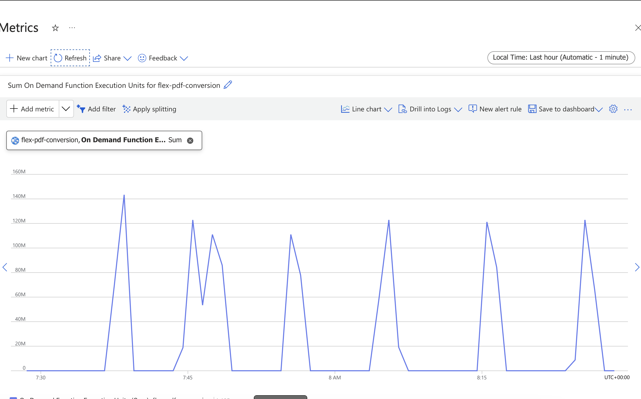

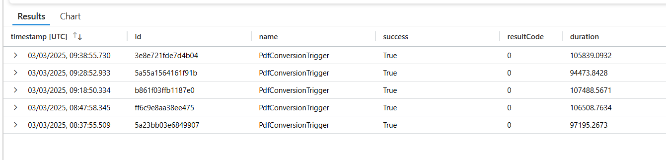

When running a longer job (say 60 - 120 sec), it removes the item from the queue, performs the processing, and exits. However, it then repeats the processing for the queue item every ten minutes until the message is dequeued. I can see this happening as the file produced by the CreatePDF method is produced five times, with time stamps ten minutes apart. The message is then added to the poison queue.
With longer jobs, which take more than ten minutes to process, the function runs for ten minutes, and then appears to just restart (usage is constant and high for ten minutes, drops to zero, and then repeats a total of five times). The message is then added to the poison queue.
