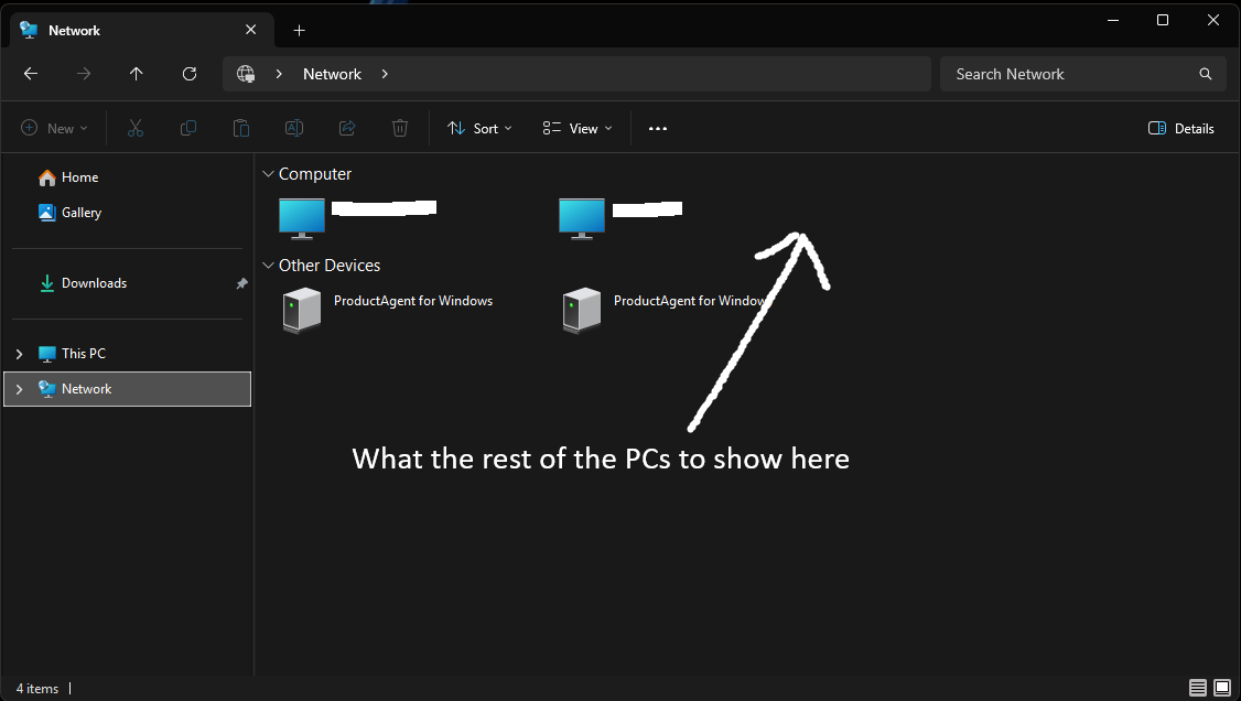

Hello everyone
Looking for some help. I have 5 PC on my home network all set up for file sharing. all communicate with each other if i use the address bar in File Explorer but only 2 show up in Network tab. Question is how do i get them all to show in the Network tab.

    2025-01-24T04:10:19+00:00
    Thank you for replying Zunhui
    I have done all that has been asked in your reply and still not showing the missing computers in the network tab in file explorer.

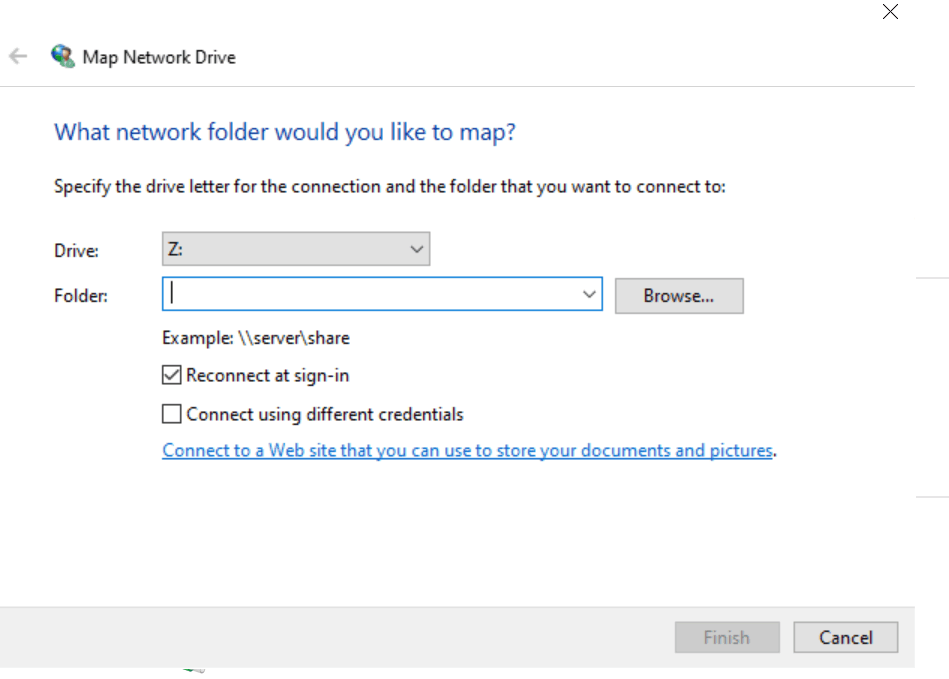

    2025-01-24T09:25:31+00:00
    Thank you for your reply, you can try to map the shared file by mapping the network drive and check "Reconnect at login" to see if this problem can be solved:
    Best Regards
