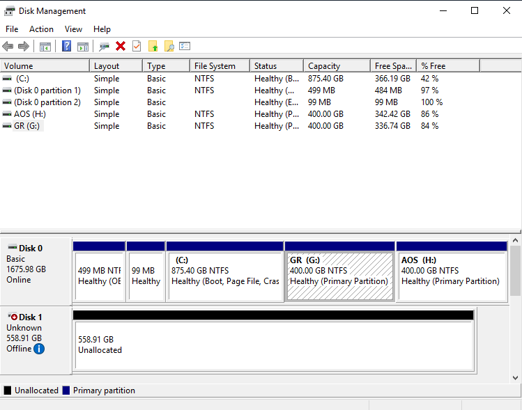

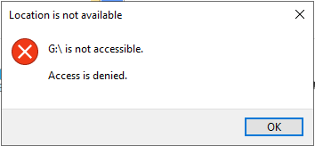

I have windows server 2019- one time it hang and after power reboot apart from the C: drive all other drive including CD Drive is showing error- "Location is not available" and G:\ is not accessible. Access is denied error.
If I am checking the volume in the disk management it is showing me Healthy.
Please support to resolve this.

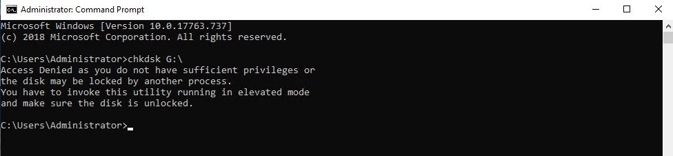

    2024-03-30T07:22:23+00:00
    I am trying chkdisk with elevated mode but still getting this error.

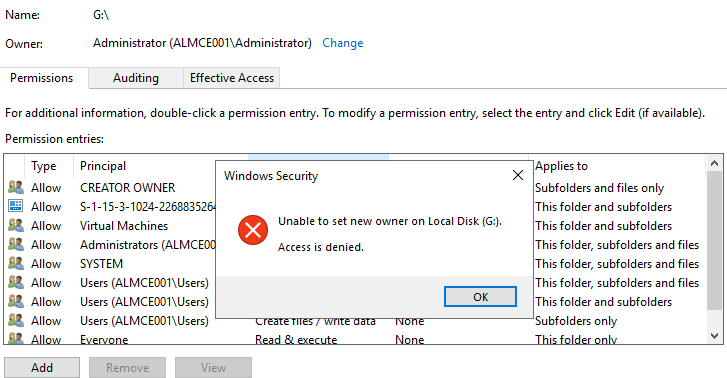

    And trying to change security permission to Administrator but not able.
    By default it was set to "SYSTEM".
