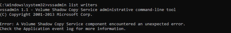

Hello I am running into an issue with some form of access and VSS. This was working fine a few weeks ago and then last week I saw the backups failed so I went to check and saw that Veeam was unable to connect to the VSS server on the system. From there I tried to run "vssadmin list writers" on the issue system but that currently states: Error: "A Volume Shadow Copy Service component encountered an unexpected error. Check the Application event log for more information."

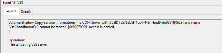

Event ID 13 - Volume Shadow Copy Service information: The COM Server with CLSID {e579ab5f-1cc4-44b4-bed9-de0991ff0623} and name IVssCoordinatorEx2 cannot be started. [0x80070005, Access is denied. ] Operation: Instantiating VSS server
Event ID 8193 - Volume Shadow Copy Service error: Unexpected error calling routine CoCreateInstance. hr = 0x80070005, Access is denied. . Operation: Instantiating VSS server

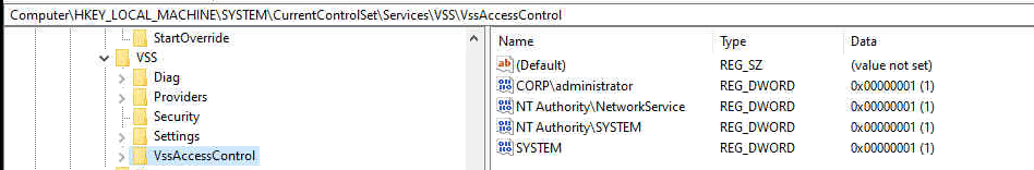

  • Added Admin, network service, and system to regedit VSS/VssAccessControl, as DWORD with values set to 1.

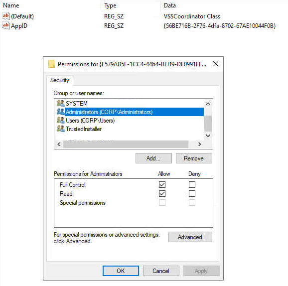

  • Added full control of the CLSID to the admin account as recommended by another source.

    1.open Regedit and navigate to the following key: HKEY_LOCAL_MACHINE\SYSTEM\CurrentControlSet\Services\VSS\VssAccessControl.
    1. Change the value of NT AUTHORITY\NETWORK SERVICE (REG_DWORD) to 1.

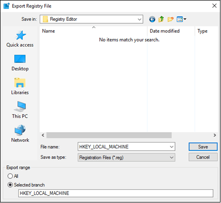

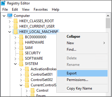

    *Before changing the value of NT AUTHORITY\NETWORK SERVICE (REG_DWORD), please back up the registry editor by the following steps first.
        a. Right-click HKEY_LOCAL_MACHINE then click Export.
        b. Export the file to any location you want and name the file.

    2024-06-10T12:35:07+00:00
    Thanks for the reply! I mentioned in the attempted fixes tat this was added along with other accounts recommended, but did not provide a screenshot. Here is that now:
    As stated ever with this the error still occurs.
    2024-06-11T11:58:14+00:00
    This appears to be the case already as shown below:
    Upon updating this entry, the error still persists with no change.

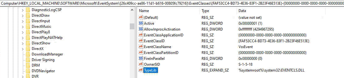

    2024-06-11T07:33:23+00:00
    Hi UnderAdmin,
    This problem occurs because the registry path of the Eventcls.dll file is incorrect.
    To resolve this problem, follow these steps:

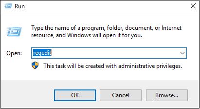

    1. Click Start, type regedit in the Search programs and files box, and then press ENTER.
    2. Locate and then click the following registry key: HKEY_LOCAL_MACHINE\SOFTWARE\Microsoft\EventSystem\\{26c409cc-ae86-11d1-b616-00805fc79216}\EventClasses\\{FAF53CC4-BD73-4E36-83F1-2B23F46E513E}-{00000000-0000-0000-0000-000000000000}-{00000000-0000-0000-0000-000000000000}
    3. Double-click the TypeLib registry value.
    4. In the Value Data box, type %systemroot%\system32\EVENTCLS.DLL, and then click OK.
    5. Exit Registry Editor.
