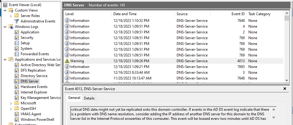

    You can try to check the DNS server under "Applications and Services Logs".
    For example:
    If you have any question or concern, please feel free to let us know.

    2024-01-10T10:02:13+00:00
    Hi Daisy,
    Thanks for the information, i will check and report back but I think the ping checks were already made and successful using IP address and host.
    I just wondered if there were any logs I could check on the app server that might give me some kind of indication of what might have gone wrong at that particular time.
    Regards.
