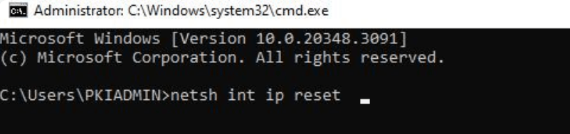

      If the issue is related to the Windows network stack, you can reset it by running the following commands:
    netsh int ip reset
    netsh winsock reset
