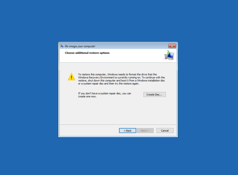

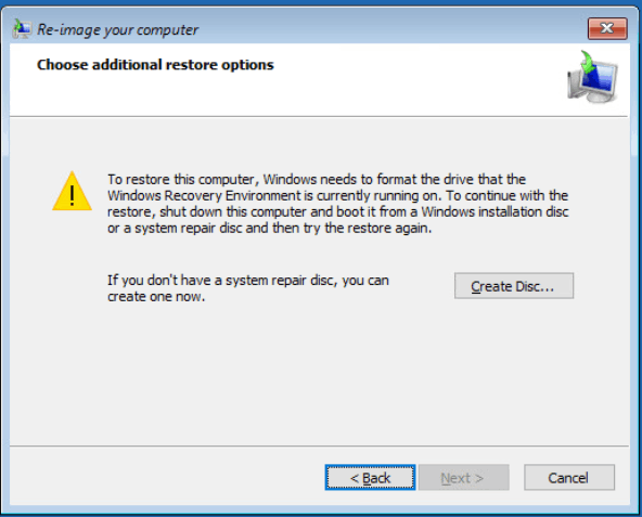

    As mentioned I followed the steps and created AD with DNS configured and took a full system backup. I created a separate volume to store this image on the machine. Now when I try to do system image recovery by booting into advanced boot options I get the following error.
    How do I fix this?

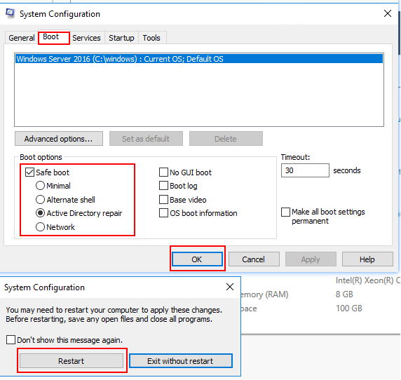

    Enter DSRM: Start->Administrative Tools->System Configuration->Boot tab->Boot options->Safe boot->Active Directory repair->click OK->In the System Configuration->click Restart.
    -or-
    Start or restart the DC, press F8 to enter the safe mode and then select “Directory Services Restore Mode”.

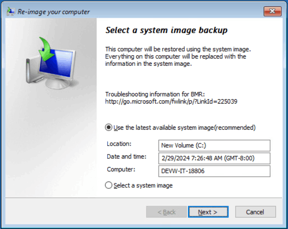

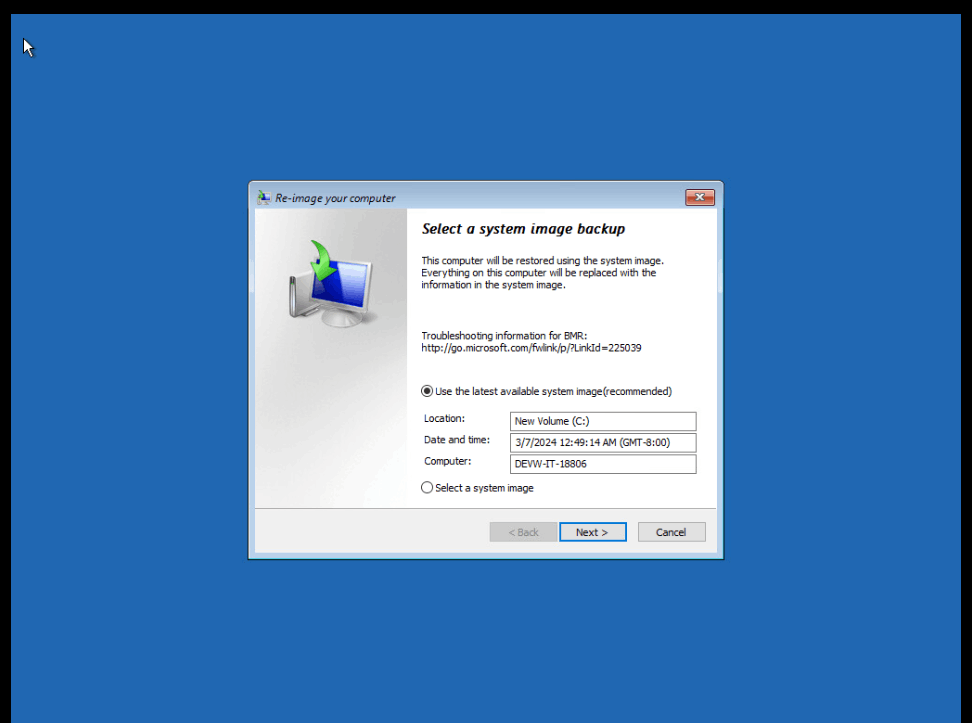

    I want to do bare metal recovery and I getting the error as mentioned above reply.
    Even with steps that you mentioned if I do a system state restore in DRSM I get blue screen after restore is completed.
    When I am doing bare metal recovery, the machine is able to detect the image but not able to restore it.
