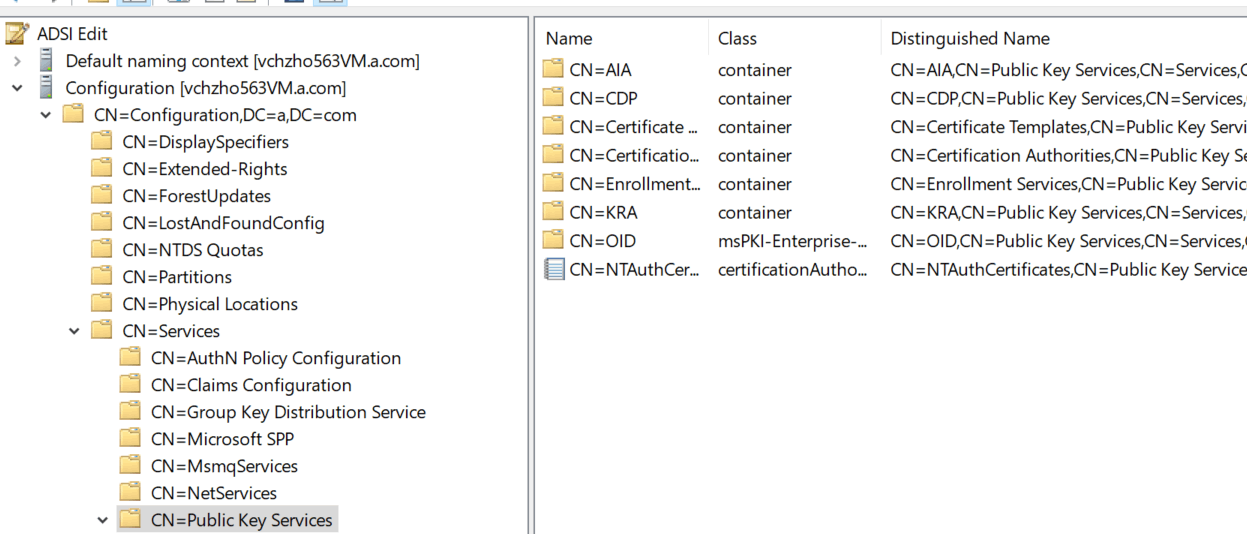

    The certificate (#0) of Active Directory Certificate Services My-Enterprise-CA does not exist in the certificate store at CN=NTAuthCertificates,CN=Public Key Services,CN=Services in the Active Directory's configuration container. The directory replication may not be completed.
    You can check if you have CN=NTAuthCertificates in CN=Public Key Services container as below.

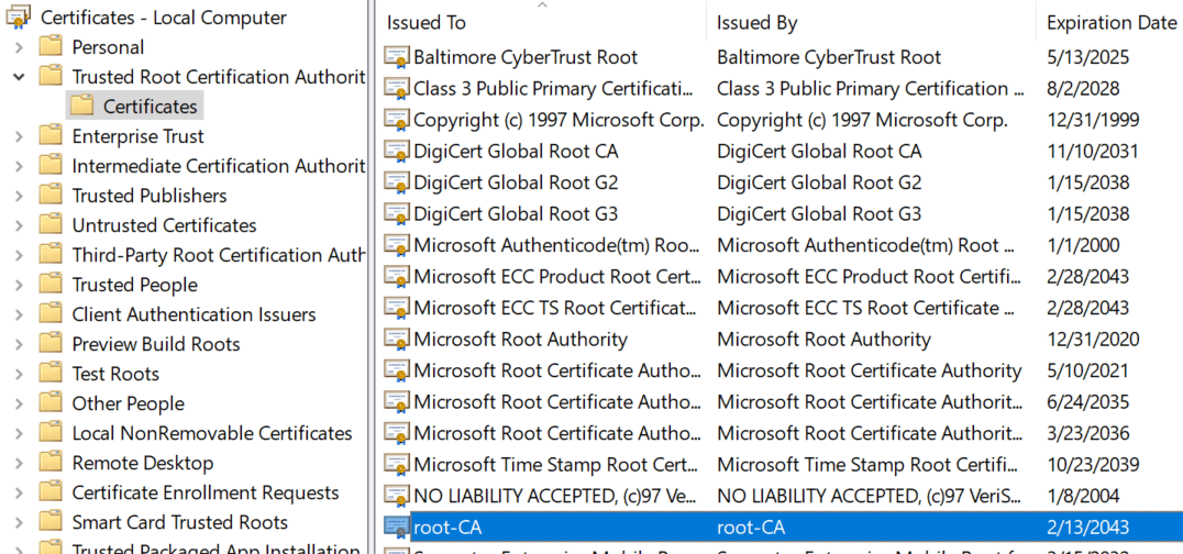

    1. For CertificationAuthority Event ID: 103, you can open certlm.msc console on CA server and check if the root CA certificate is in trusted root certification authorities container?

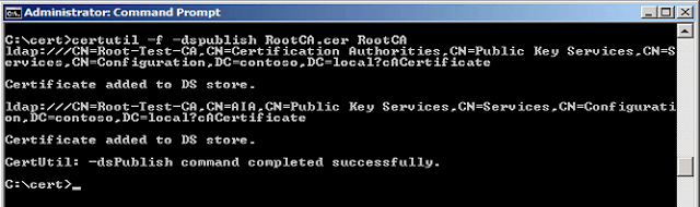

    If no, you can publish root certificate to domain by running command:
    certutil -f -dspublish <the full path of the rootCA.cer> RootCA
    For example:
    RootCA.cer is the root CA certificate file name and rootCA is the CA name.

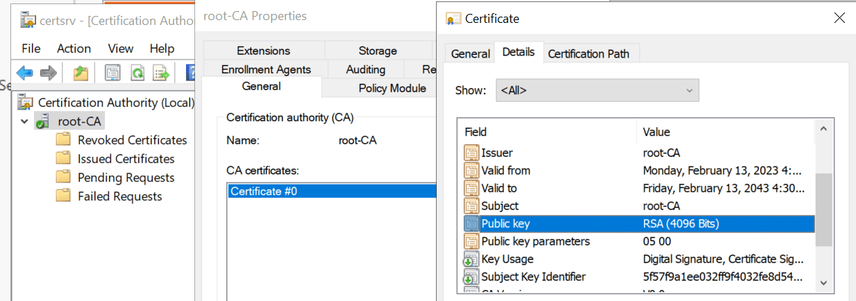

    3.You can check the Publish Key bit on root CA and issuing CA(it is 4096 bits below).
