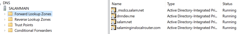

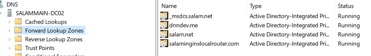

    2024-03-07T09:29:52+00:00
    Hi, Yes both SALAMMAIN and SALAMMAIN-DC02 have DNS roles
    This is screenshot for DC2 DNS
    Screenshot for DC1
