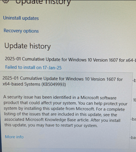

    2025-01-17T07:53:43+00:00
    Hello Molly,
    Thank you for your response and the suggested solution. I have already tried the recommended steps, but unfortunately, they did not resolve the issue. The problem also occurs when trying to install KB5049993 on Windows 10 Enterprise 2016 LTSB.
    Do you have any other suggestions to address this issue?
    Thank you for your assistance.
    • Installation Failure: Windows failed to install the following update with error 0x800F0845: 2025-01 Cumulative Update for Windows 10 Version 1607 for x64-based Systems (KB5049993).
