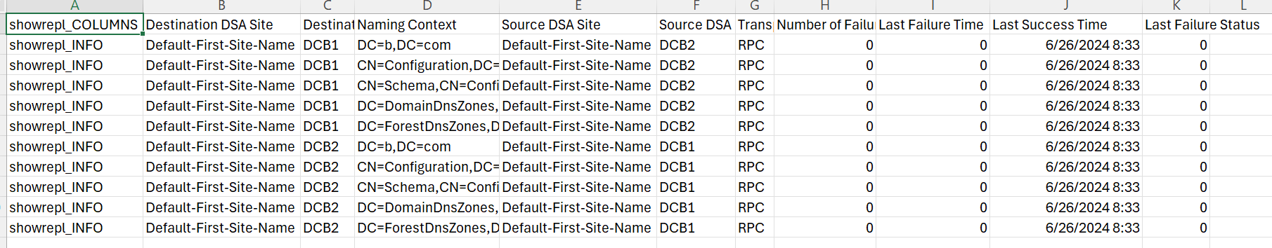

    For the last command, after you run this command and open the result file, you can see it likes below.
    I have no Netlogon share nor sysvol.

    the showrepl and replsum both came back Ok, but the last one I had this. I also noticed that viewing the netshare again, I have no Netlogon share nor sysvol.
    Win32 Error 8419(0x20e3): The DSA object could not be found.
