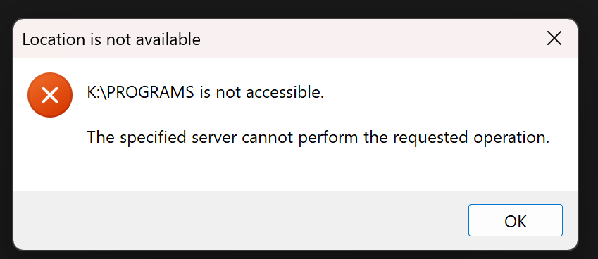

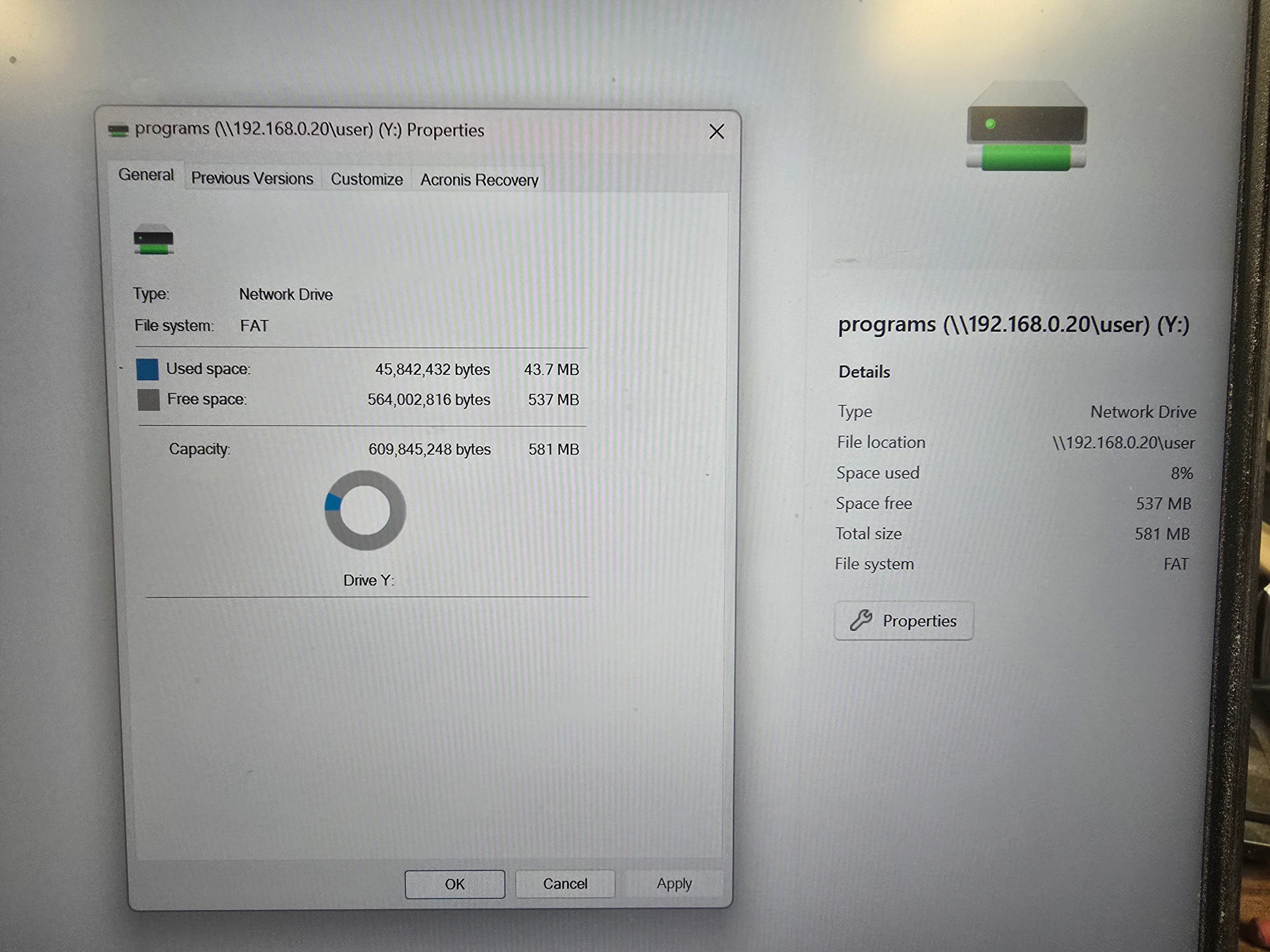

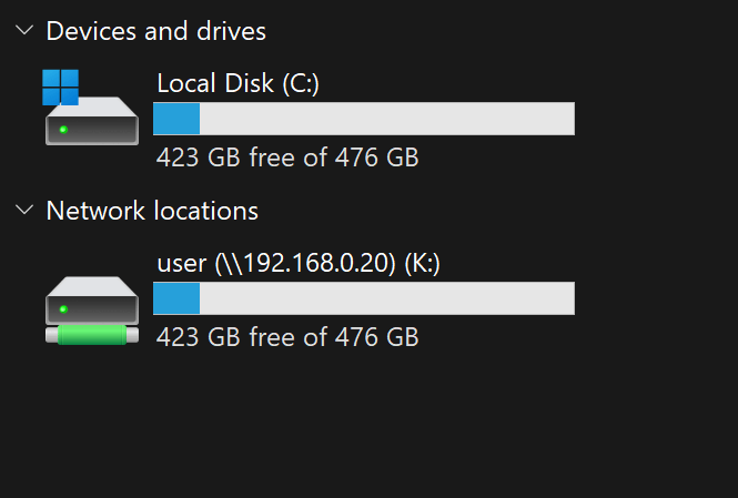

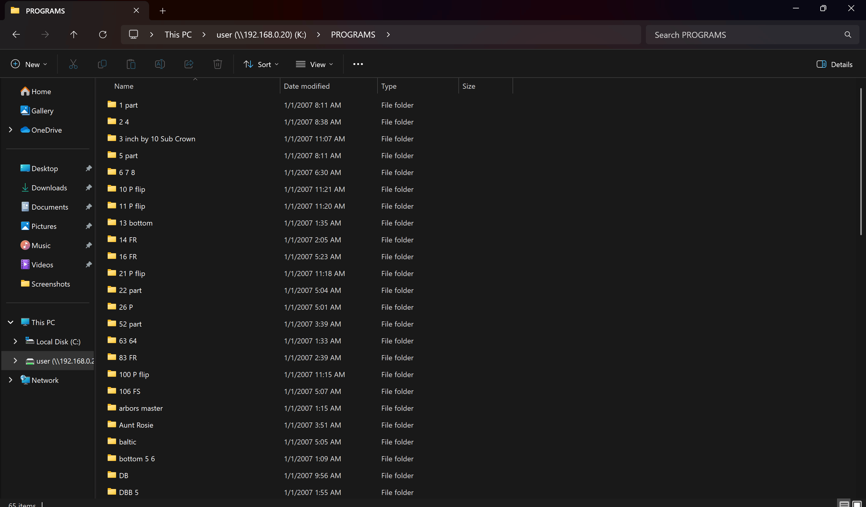

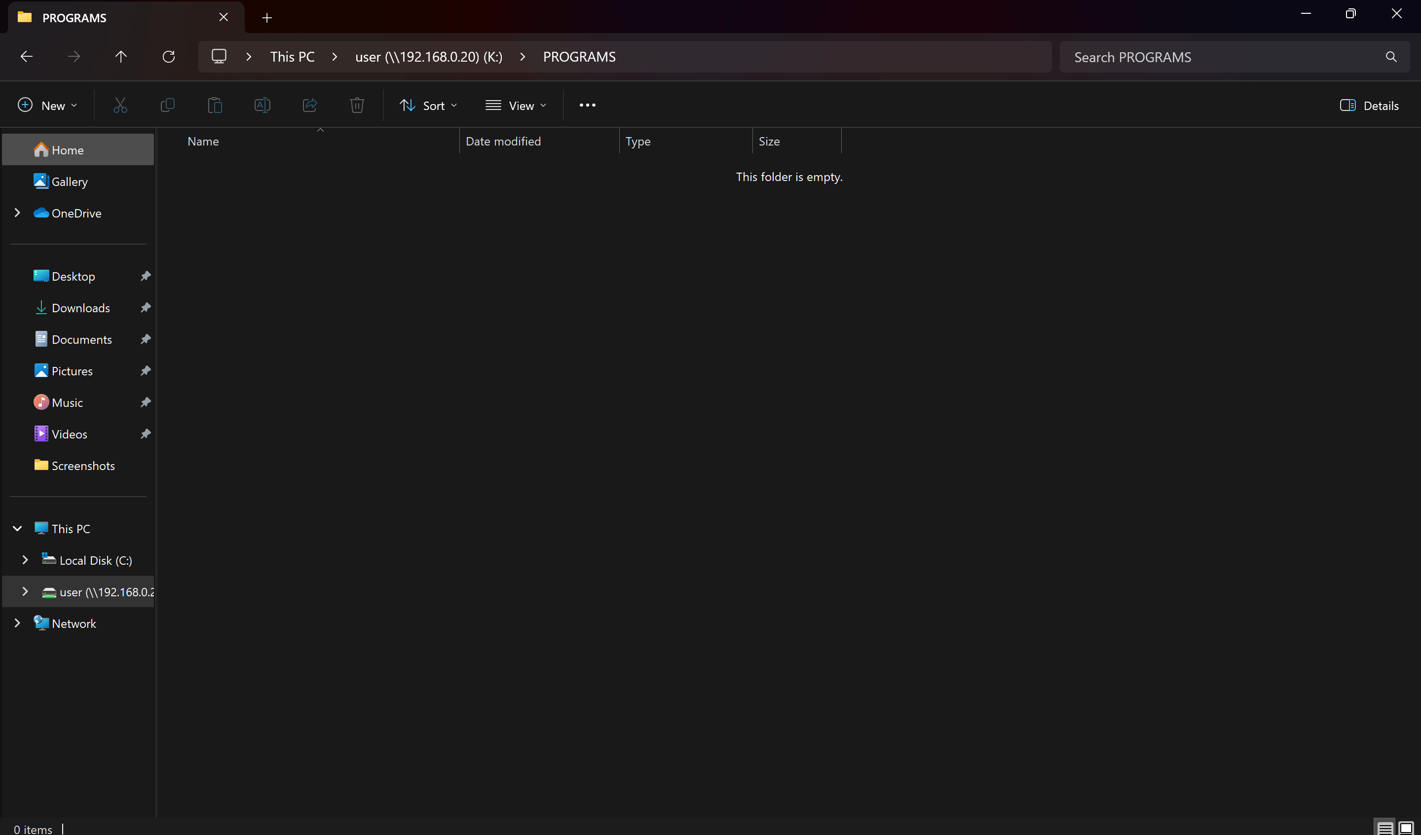

    2025-01-14T01:17:45+00:00
    I tried what you said and it didn't work, BUT I used cmd to map the drive and it *kinda* works but its really janky & unstable. net use K: \192.168.0.20\userFor example, when in This PC in file explorer it show the same used and free space as the drive in the laptopImage
    Then when accessing the drive sometimes the files are there but if you refresh or go out and back in it the files will be gone or get this error
    Actual drive (taken from production pc)
