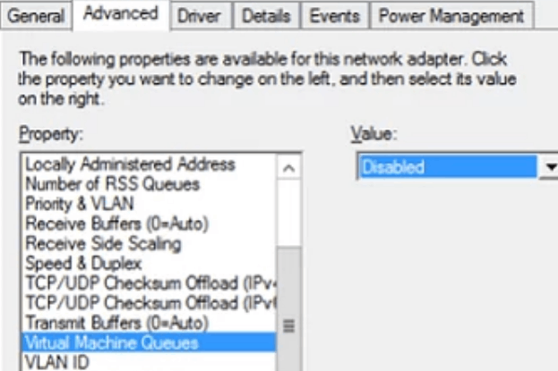

    Thanks for your reply. By default, RSC is enabled on all external switches on Windows Server 2019. I suggest you try to enable RSC on the virtual network switch on Windows Server 2022 to see if it can improve network bandwidth. In addition, if VMQ is enabled in the network adapter driver of the Hyper-V host, it may also cause poor network performance in the Hyper-V virtual machine. It is recommended that you check whether VMQ is enabled on Windows Server 2022, right-click the network adapter on the host, and then check whether VMQ is disabled in "Properties" -> "Configuration" -> "Advanced Options".

    I do not have any option for Virtual Machine Queues
