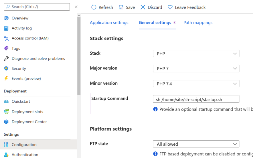

    I just had the opportunity to use Azure Web App and have a PHP script that uses Ioncube Loader to compile and I encountered the same problem. Same solution as @Anonymous answered. but would like to expand further It might be easier to understand.
    I use Azure Web App (Linux) + PHP 7.4.
    1. Go to download ioncube loader ( Linux (64 bits) ) from https://www.ioncube.com/loaders.php.
    2. extract ioncube_loaders_lin_x86-64.tar.gz
    Upload php extension file ioncube_loader_lin_7.4.so
    1. ftp to Azure Web App server
    2. At the path /site
    3. create folder php-ext
    4. upload ioncube_loader_lin_7.4.so to this path
    5. You will get file path /home/site/php-ext/ioncube_loader_lin_7.4.so
    Create custom php ini file named 00-ioncube-loader.ini contain
    zend_extension=/home/site/php-ext/ioncube_loader_lin_7.4.so
    3. create folder php-ini
    4. upload 00-ioncube-loader.ini here
    5. You will get the file path /home/site/php-ini/00-ioncube-loader.ini
    Create startup.sh script file contain
    #!/bin/bash
    cp -a /home/site/php-ini/00-ioncube-loader.ini /usr/local/etc/php/conf.d/
    3. create folder sh-script
    4. upload startup.sh to here
    5. You will get file path /home/site/sh-script/startup.sh
    Add startup command to Azure Web App
    sh /home/site/sh-script/startup.sh

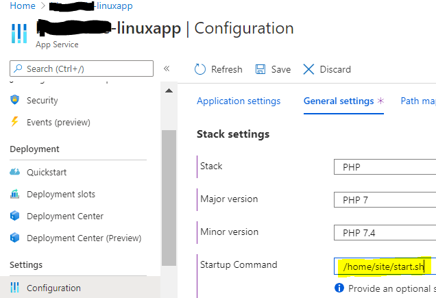

    2.Create a startup file, example (start.sh). At this, you can copy the php.ini in the previous step to /usr/local/etc/php.
    Note: We are using a startup script since the files which are not under /home will not persist when the WebApp is restarted
    3.**Configure this **startup script from Configurations blade of the WebApp, so that the script runs when the container starts:
    4.If feasible, restart the WebApp and verify using php -v command – to verify if the extensions are loaded.
