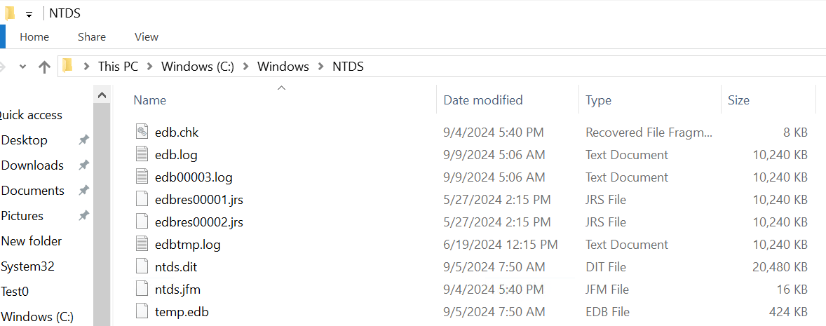

    5.NTDS folder missing on new VM means there is no Log folder and Database folder.
    NTDS folder is not replicated from old DC01.group.in, it will generate when you promote new VM to Domain Controller.
    It seems New Domain Controller is not promoted successfully.
    Ans:- but netdom query fsmo & nslookup indicating correct value to new domain controller.

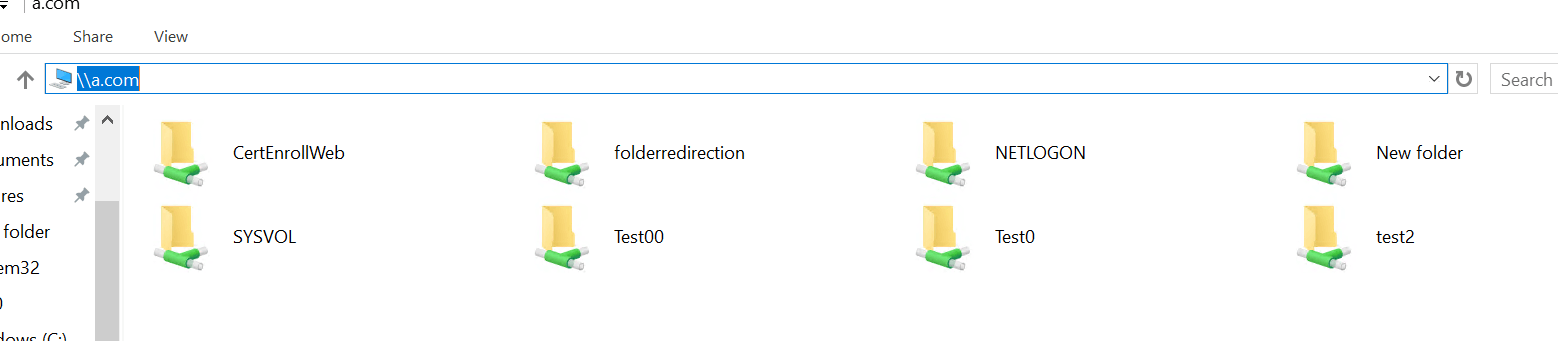

    one new VM DC.group.in , when try to access
    \DC and check shared folder (here sysvol & ntds are not showing)
    but when we created one user at new Domain controller DC.group.in , it is successfully showing on my other
    servers like DC01.group.in and ADC.group.in

    You mean there is no SYSVOL folder and Netlogon folder?
    Or you mean there is no SYSVOL folder and NTDS folder
    Please run net share on the new Domain Controller and check if SYSVOL folder and Netlogon folder is shared on new DC.
