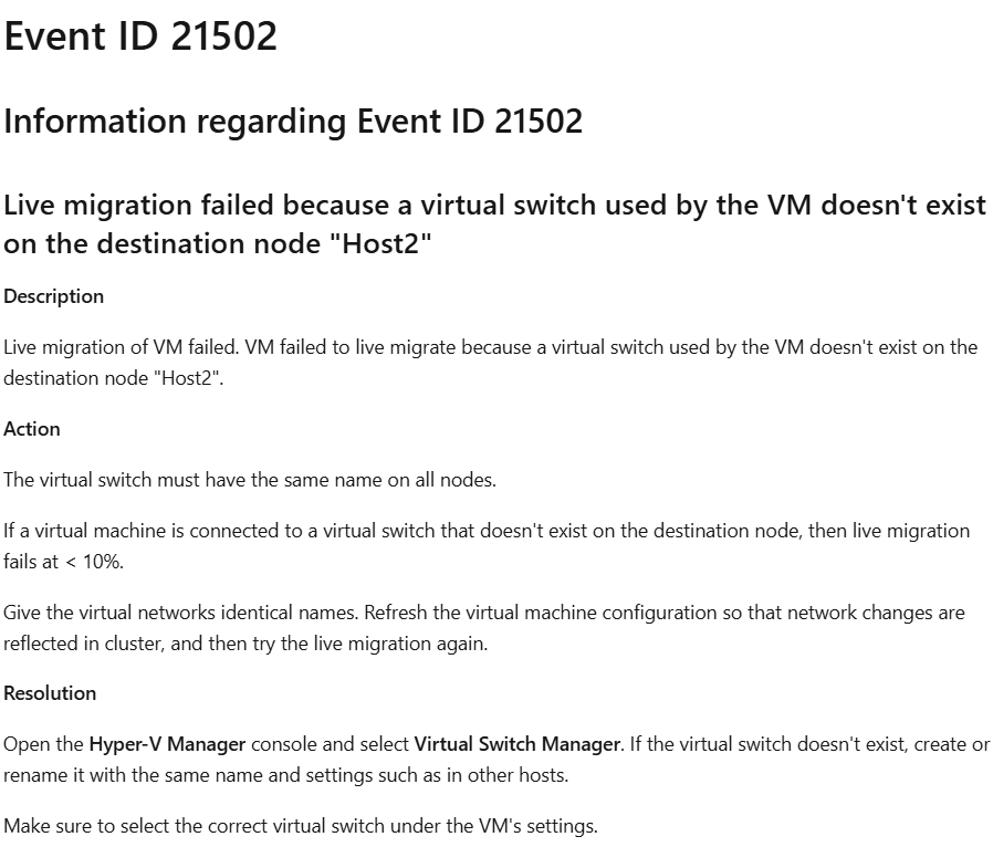

    Many thanks for your response, there are minimal messages in the event log, it basically reports
    Hyper-V_High-Availability Event ID:- 21502 - Live Migration of "" Failed
    Hyper-V-VMMS Event ID:- 21026 0 Virtual machine migration operation for "" failed at migration destination
    They give basic generic errors, nothing that when i have a search around gives any define reason why this would happen.

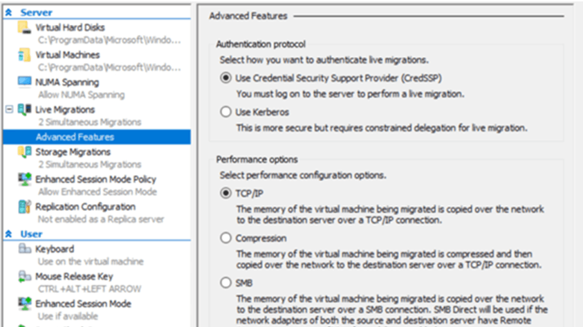

    I suggest you to try to change the live migration setting option to TCP on both source and destination side to see if it can solve the problem, refer to the following:
    1. Open the Hyper-V Manager of both nodes.
    2. Click hyper-V settings. expand Live migrations. select advanced features, and select TCP/IP in Performance options.
    You can also try the method in the link I provided above.
