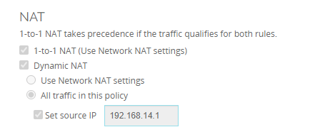

Now what will probably be most helpful for those facing this issue (as a workaround) is that I can make a firewall policy for systems trying to connect from the SSL VPN network to this PC and set the source IP of the remote system to the firewall Address (fooling the destination computer into thinking the RDP request is coming from the LAN that it is on). and then I can connect without issue. the traffic looks something like this and the RDP connection works

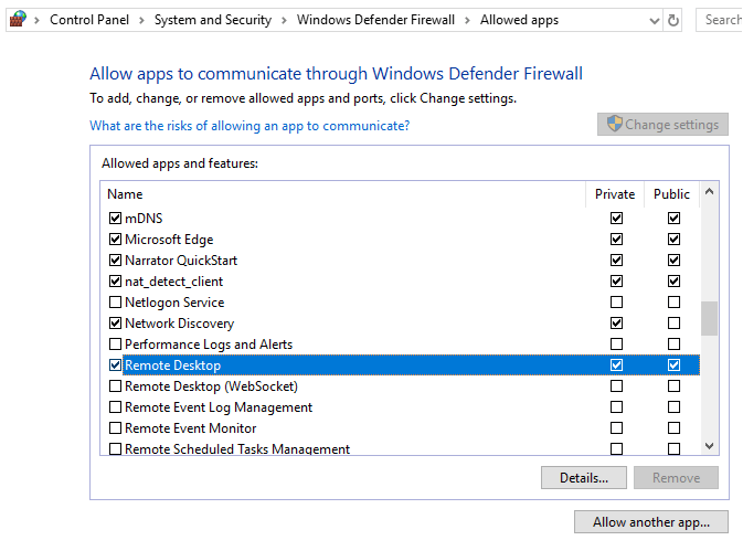

    First, you need to confirm whether Windows Defender Firewall or other firewalls allow RDP (Remote Desktop Protocol) traffic to pass through. You can check the firewall settings and make sure TCP port 3389 is open. Second, make sure that the routing between the different subnets is configured correctly. A router or intermediate device needs to be properly configured to be able to pass traffic from one subnet to another. Then you need to check if the network configuration of your Windows 11 computer, including the IP address, subnet mask, default gateway settings is correct.
    So, here are some actions you can try:
    1. Open Control Panel and select System & Security -> Windows Defender Firewall. In the left-hand menu, select Allow apps or features to pass through Windows Defender Firewall. Confirm that Remote Desktop is in the list and that it is checked under the network configuration you are using, such as private and public.

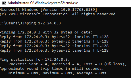

    1. Make sure that the VPN is properly configured and that it is able to successfully connect to the destination network. Test the basic network connection to make sure that the IP address of the target computer can be pinged after the VPN connection.

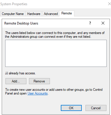

    2. Check if the user account used to log in to Remote Desktop has remote access. You can add users to the Remote Desktop Users group. Press Win+R to open the "Run" dialog box, enter "sysdm.cpl" and press Enter. In the Remote tab, click Select User..., and then add the appropriate user.

    Now if I create a rule in my firewall to set the source IP of the client on the VPN to look like it is coming from the Same LAN the system then responds and RDP is established.

    The workaround I have in place does allow for RDP to work again on the affected machine. Sadly I can't find any known settings or events that lead me to resolve the actual behavior. As I mentioned before I have 2 Win 11 PCs same build one responds to RDP and works fine the other does not and all relevant RDP settings are the same on both. Not sure exactly what your firewall looks like but in your situation the rule might look as follows
    Create a new firewall policy on the firewall that the destination PC is sitting behind, and give the destination computer an IP reservation on its network. Lets say 192.168.200.187. then the rule is basically
    Any Traffic From: 192.168.10.0/24 to 192.168.200.187 on port 3389 allow and Set source IP to the Default Gateway of the firewall. On mine the last part looks like this and is under advanced settings in the firewall
    Obviously replace the source with the DG of the 200 networks.
    this seems to trick the destination computer into responding and dynamic NAT seems to take care of the rest, but I have only tested on Watchguard firewalls.
