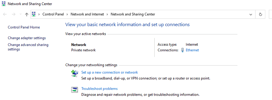

    1. Check Network Discovery Settings:
    Go to SettingsNetwork & InternetEthernet or Wi-FiNetwork and Sharing Center.
    Under "Advanced sharing settings," make sure that "Network discovery" and "File and printer sharing" are turned on.

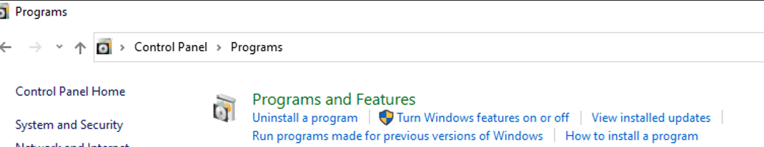

    1. Enable SMB 1.0 Support: Windows 11 disables SMB 1.0 by default. Some NAS devices (like TrueNAS) may still use SMB 1.0. You can try enabling it:
    Open Control PanelProgramsTurn Windows features on or off.
    Check SMB 1.0/CIFS File Sharing Support, then click OK.
