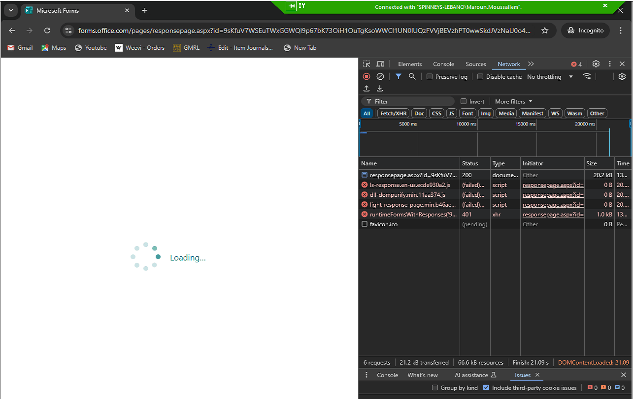

I have an issue with forms.office.com, it's not loading all its content.
We have two dns server in the head office, a primary (192.168.0.5) and an alternative (192.168.0.6). everything works fine in the HO with the users, also in each branch we have a dns server (192.168.x.x) and the alternative is (192.168.0.5) and the link above works fine.
we faces issue in the small branches where there is no a dhcp server nor a dns server. we configure a dhcp server on a master aruba ap and we set the dns server as follow (192.168.0.5) on the aruba ap.
the forms.office.com, does not fully load, unless I set a static primary dns server ip : 8.8.8.8 on each pc and an alternative ip:192.168.0.5, if i set google's dns server as an alternative the page won't load.
note that all branches are connected to the head office and passthrough the firewall to go public.
Any help?
