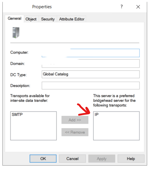

There was a planned power outage at a site which hosted the domain controller. The other site has a read only domain controller.
When the domain controller went down, the computers at the remote site were unable to authenticate and log in.
I've added the read only domain controller role to the other site and don't understand why the local users were unable to authenticate.
I didn't have the inter-site data transfer. Was this the cause?

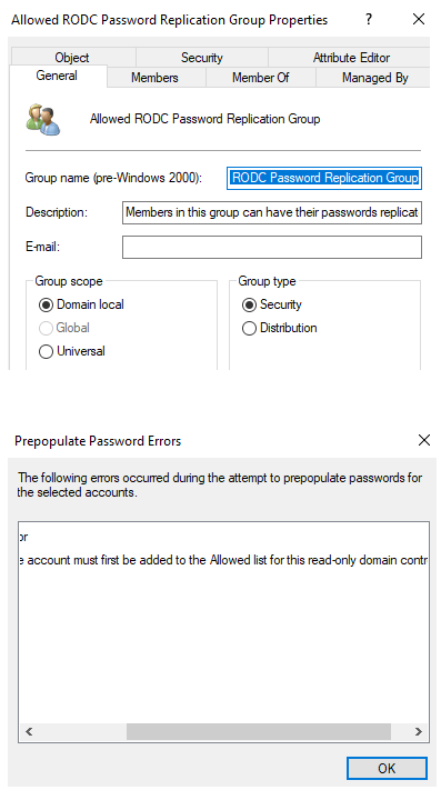

    2025-01-02T12:59:01+00:00
    Hi Neuvi,
    Thanks for your input. I've created a group policy filtering only on the RODC for the cache credentials.
    I've added the users to the "Allowed RODC Password Replication Group". When I went to test it by prepopulating the password to the RODC, I get the error "account must first be added to the Allowed list for this read only domain controller. Let me know if you have any ideas on the cause.
