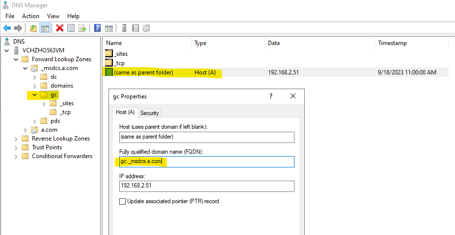

    2.You can try to check whether the two DNS records mentioned above actually exists or not on both 2016 Domain Controllers.
    For example:
    gc._msdcs.mydomain.com
    ![Image](https://filestore.community.support.microsoft.com/api/images/eda8fd29-f204-4a8a-9e7f-baa0f930b7a9?upload=true&fud_access=wJJIheezUklbAN2ppeDns8cDNpYs3nCYjgitr%2bfFBh2dqlqMuW7np3F6Utp%2fKMltnRRYFtVjOMO5tpbpW9UyRAwvLeec5emAPixgq9ta07Dgnp2aq5eJbnfd%2fU3qhn54Ui9c7IY3%2bVaDGM794ieFEWFOTytTrMKy7m1XQpeIKlfhHZvv6qxFNypZh8EVO%2bjzMgLRnj7SrY%2fjVoV7qs8fDiK994oMxVrhrFAMYDcU%2fzou6ZMBv031TY0S0DcqhtZ4e19FhO%2b86DRZsMqMnqYpOPQBNUHnhIds4Jo3WsVhhVyuY2RtUDUU8BwaiqPCg2wF2tSCVk0ESbl%2bYGOnilP4z5ywK5VcuRfiKF4Fw6AjPp0BbBSzrwxmFPR72QC7HdBtiaI4TN4e0UjkS%2b6YXioorKUnJKq9OalAg5llI9QUtz8%3d)

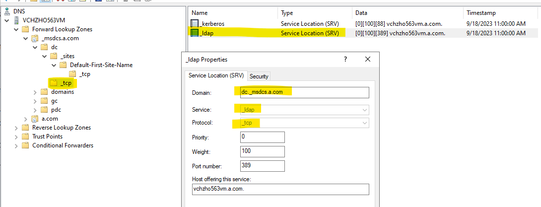

    And _ldap._tcp.dc._msdcs.mydomain.com
    ![Image](https://filestore.community.support.microsoft.com/api/images/231c1662-9bf8-48fa-8361-2be6ab8eb55b?upload=true&fud_access=wJJIheezUklbAN2ppeDns8cDNpYs3nCYjgitr%2bfFBh2dqlqMuW7np3F6Utp%2fKMltnRRYFtVjOMO5tpbpW9UyRAwvLeec5emAPixgq9ta07Dgnp2aq5eJbnfd%2fU3qhn54Ui9c7IY3%2bVaDGM794ieFEWFOTytTrMKy7m1XQpeIKlfhHZvv6qxFNypZh8EVO%2bjzMgLRnj7SrY%2fjVoV7qs8fDiK994oMxVrhrFAMYDcU%2fzr5kJXGFqmDGuGi2ac1k0IMYZG4OldSpf821vPsCAl9%2bXG3Fgu5nmePHTyr38ijHrxCi%2b8PXEh8vIyokleWqGJmhJQ%2fUDPQ%2fPNJGkaLE2mIyFTl%2fpg7nndvDxzOBUe5OVFDC69XXJBwpUNFxoDyFLY10v4POPFFn6iM5DqDV3PQBYpe9ym5QUMS4aaywRZiIMc%3d)
