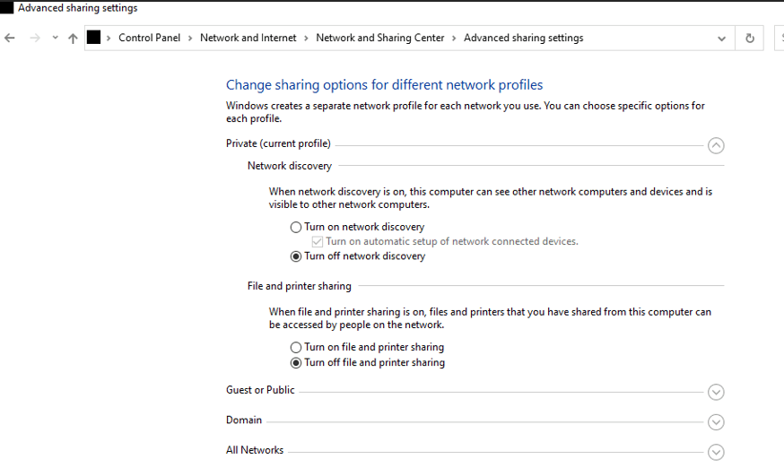

    Thank you for reaching out. Based on your description, the issue seems to be related to recent update on the Windows 11 computer might have caused an issue with the network credentials. Here are a few steps you can follow to resolve this issue:
    1. Ensure File Sharing is Enabled on the Server (Windows 10)
    On the server, go to Control Panel > Network and Sharing Center > Change advanced sharing settings.
    Make sure Turn on file and printer sharing is selected.
    Under All Networks, ensure Turn off password protected sharing is selected (since other computers do not require credentials).
