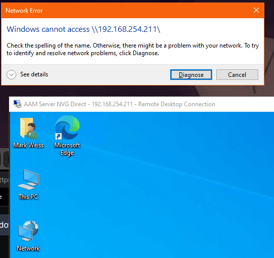

I'm trying to move my webserver to the outer tier router in my 3-tier network.
Presently, it only works on the inner tier:
I have a fiber connection with ONT feeding a NVG468MQ router. Behind that router I have a Linsys WRT3200ACM. Behind that, I have a second WRT3200ACM. My monitoring PC is behind that third router. My server is usually behind the second router. I can access the server both through RDP and Network icons when it's connected to that router.
However, when I connect server to the outermost router, I can only remote desktop into it; but I get a network error if I try to access any shares on that server as follows: I also cannot ping that IP address. Is there a limit of one router to look downstream to a PC on the next level outside? Is it because I'm behind two routers instead of one when the server is connected to the outermost router that I cannot access shares or ping that IP?
I've tried these commands as well:
[code]
netsh interface IP delete arpcache
arp –a //to display the ARP cache
arp –d //to clear ARP cache
ipconfig /flushdns
netsh winsock reset
[/code]

    2024-04-16T14:30:55+00:00
    The only change I made was plugging my webserver into a different router. I did not turn on any firewall. I've got the outermost router setup to accept traffic on all the ports needed, just like the inner router.
    The web sites on the server cannot be accessed when it is on the outermost tier of the network.
    Network shares cannot be accessed either.
    The ONLY thing I can do is use remote desktop.
    It seems strange that network drive shares cannot be accessed as well as no visibility of web server.
    When the server is behind TWO routers, all these features work. When it is behind just ONE router, everything but RDP fails.

    2024-04-18T16:36:05+00:00
    That would be logical, except that I am going through one LESS router and I've configure the remaining router to have the same pinholes in the firewall.
    I'm convinced that this is a Windows problem because WIndows created "Network 2" when I plugged the server into this outside router.
