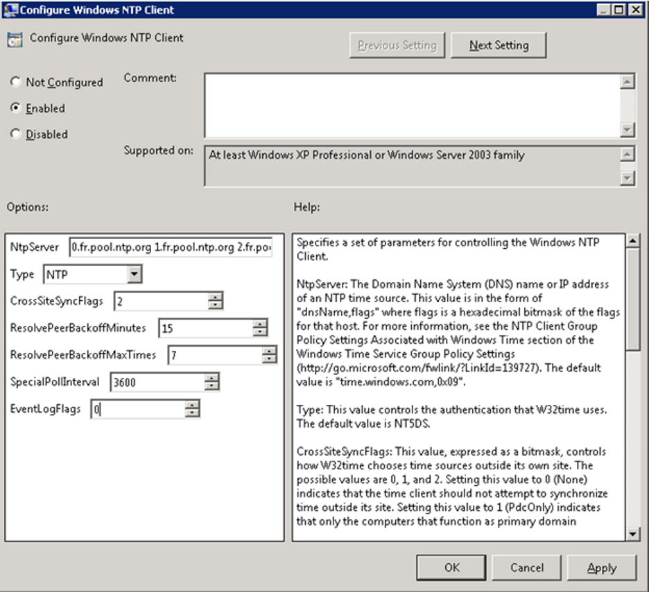

    You need to create a Group Policy in which you will enable and configure the following parameters:

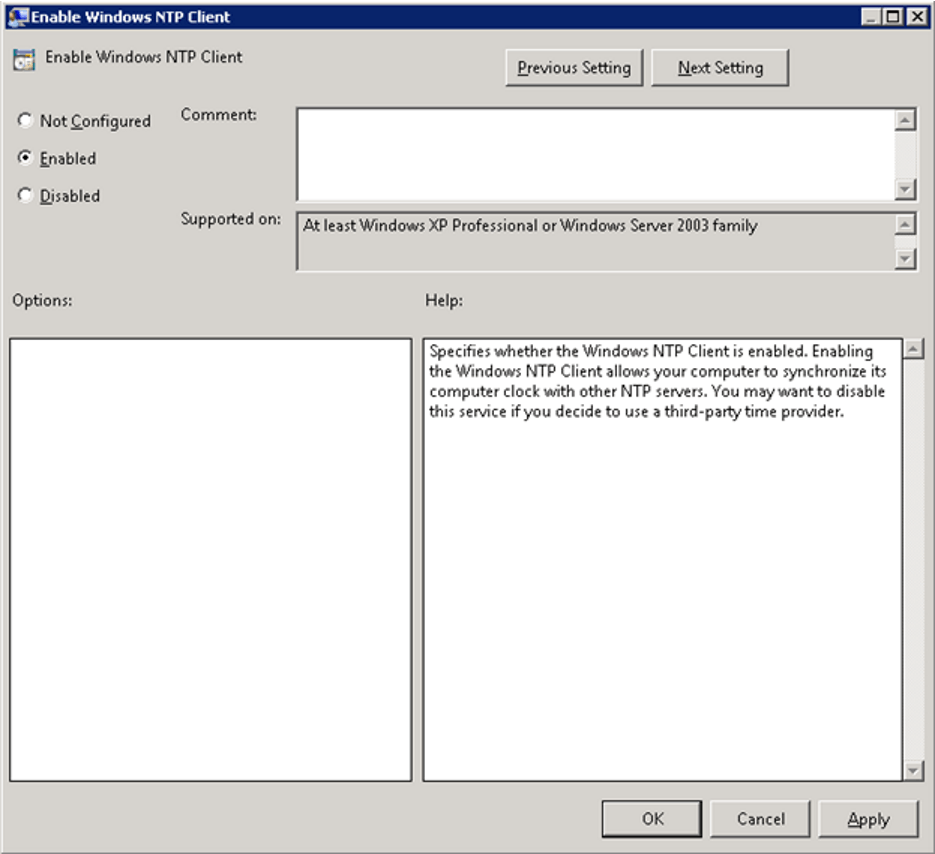

    • Computer Configuration\Policies\Administration Templates\System\Windows Time Service\Time Providers\Enable Windows NTP Client should be enabled
    • Computer Configuration\Policies\Administration Templates\System\Windows Time Service\Time Providers\Configure Windows NTP Client should be enabled with “NTP” as Type and the NTP server(s) to use set as NtpServer (You can add multiple NTP servers by separating them with a white space)

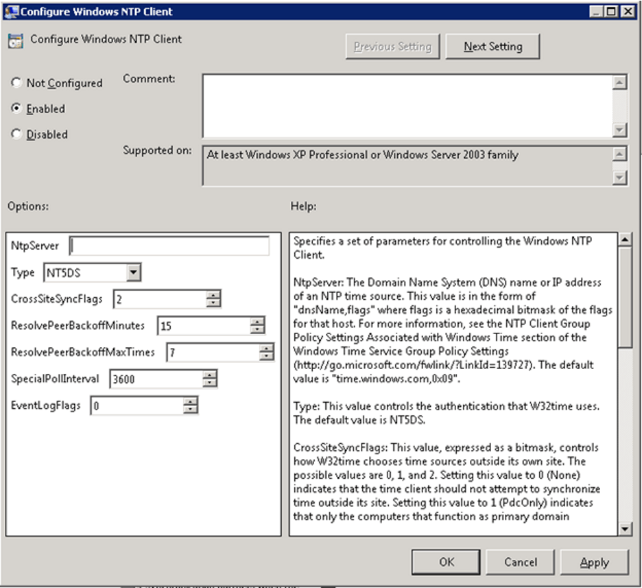

    Other domain controllers, member servers and Workstation:
    • Computer Configuration\Policies\Administration Templates\System\Windows Time Service\Time Providers\Configure Windows NTP Client should be enabled with “NT5DS” as Type
    NT5DS is domain hierarchy-based time synchronization.
