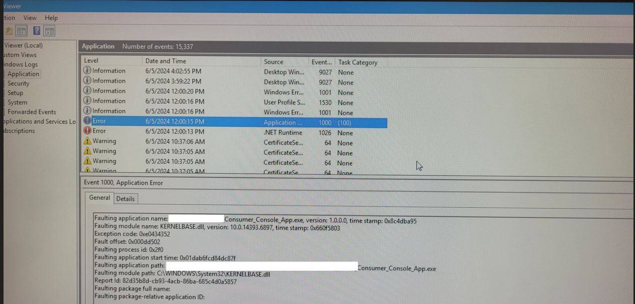

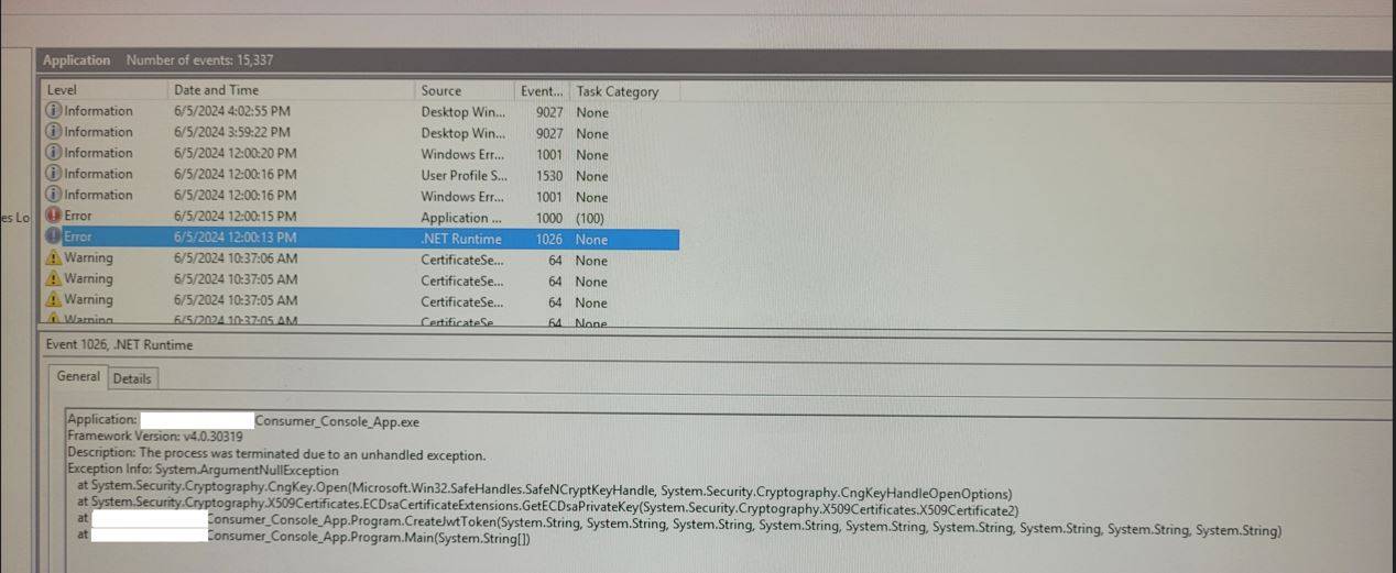

We've set up a scheduled job in Windows Task Scheduler for our Console Application to run daily at 12 PM. It was functioning properly until January 2024, but since then, we've experienced intermittent issues. Whenever the problem arises, we've been able to resolve it by manually running the job.
Attached the screenshot for your reference.

    The screenshot you attached shows the source of this error is .NET Runtime, which suggests a problem related to the .NET Framework during execution.
    The Event ID is 1026, the error code 0xE0434352 indicates a low-level CLR exception.
    Check that your application is running on the correct version of the .NET Framework. Compatibility issues can arise if you’re using outdated or missing .NET Framework versions. Also double-check your scheduled task settings in Task Scheduler. Ensure that the task is configured correctly, including the working directory, user account, and permissions.
