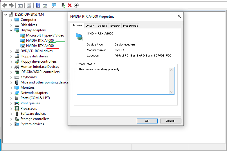

I’m facing an issue with NVIDIA GPUs in my Windows virtual machine (VM) using Hyper-V with Discrete Device Assignment (DDA).
I’ve added two GPUs to my Hyper-V Windows VM, both visible in Device Manager under Display Adapters. However, one GPU is working perfectly, while the other is encountering a Code 12 error.
Here’s what I’ve tried:

  3. Device Manager Status:
    • Both GPUs are visible in Device Manager under Display Adapters.

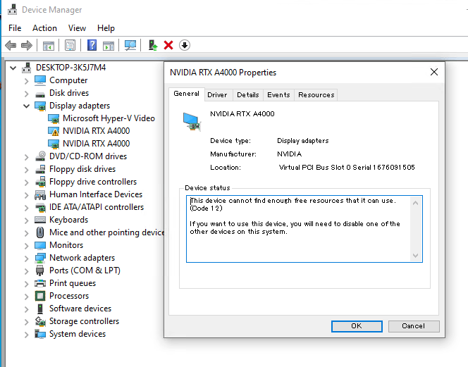

  4. Code 12 Error:
    • One GPU is working fine.
    • The second GPU, however, displays a warning and is not functioning properly.
    • The error message states: “This device cannot find enough free resources that it can use. (Code 12) If you want to use this device, you will need to disable one of the other devices on this system.”
5. Disable/Enable Test:
  • When I disable the GPU1 adapter, GPU2 works fine.
  • Enabling GPU1 and disabling GPU2 and vice versa also confirms the individual functionality of each GPU.

    The aforementioned issues were successfully resolved by configuring MMIO space, as outlined in the official Microsoft document: [Microsoft Official Document]
    GPUs, particularly, require additional MMIO space for the VM to access the memory of that device. While each VM starts with 128 MB of low MMIO space and 512 MB of high MMIO space by default, certain devices or multiple devices may require more space, potentially exceeding these values.
    Subsequently, I reconfigured the VM following the instructions in the Microsoft Official Document: [VM Preparation for Graphics Devices]
    Solution :
    • Enabled Write-Combining on the CPU using the cmdlet: Set-VM -GuestControlledCacheTypes $true -VMName VMName
    • Configured the 32-bit MMIO space with the cmdlet: Set-VM -LowMemoryMappedIoSpace 3Gb -VMName VMName
    • Configured greater than 32-bit MMIO space with the cmdlet: Set-VM -HighMemoryMappedIoSpace 33280Mb -VMName VMName
