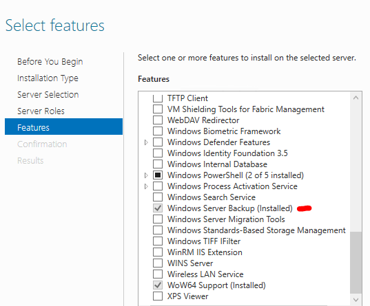

windows server backup was already installed which was used long ago, but now it is not showing anywhere to open. this is my domain controller server 2016 standard(GUI).
I have searched some articles where it says to install the Network Load Balancing feature. but why should I install this as there are 5 servers with the same OS version on that Windows server backup is running properly without any extra things installed.
I tried uninstalling the Windows server backup feature then reboot then reinstalling the Windows server backup then reboot but still same issue.
again I tried to uninstall the Windows server backup feature then reboot then reinstall the Windows server backup providing the source from windows server 2016 setup source folder, it get install and then reboot but still same issue.
