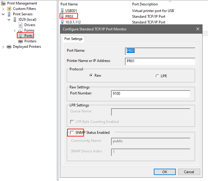

    Try to disable SNMP on all network printer-ports:

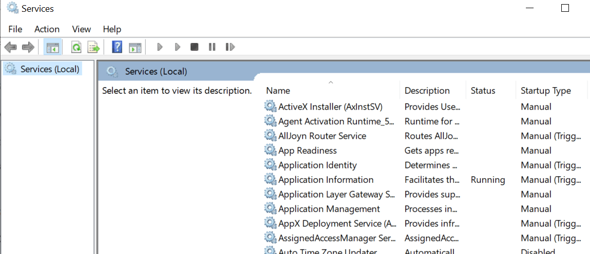

    1. Clear System Cache: Occasionally, outdated printer device entries can linger in system caches. Try clearing the print spooler cache and restarting the service:
    • Stop the Print Spooler service via Services.msc or command line (net stop spooler).
    • Navigate to C:\Windows\System32\spool\PRINTERS and delete all files within this folder.
    • Restart the Print Spooler service (net start spooler).

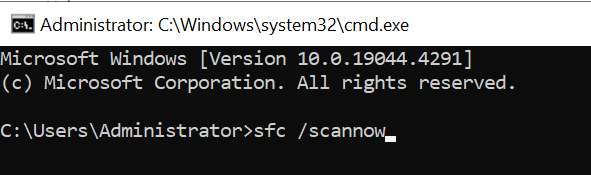

    5. System File Checker (SFC):
    Run the System File Checker to ensure that all Windows system files are correct and intact, which could potentially affect how applications handle peripheral devices like printers:
    • Open Command Prompt as Administrator.
    • Run the command: sfc /scannow.
    • Allow the process to complete and then restart your computer.
