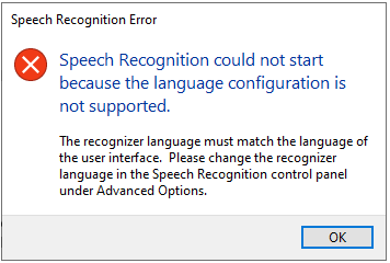

When we log into our remote desktop server as a normal user we get the message that: Speach Recognition could not start becuase the language configuration is not supported.
When we log in as an Administrator we do not see this message and it works fine.

    2024-02-20T15:41:18+00:00
    It was helpful. We went through and made some changes but we are still having the same issue.
    There were some items in your list that are a little different on windows 2022 then what you had listed.
    We still get an error that says:

    We are still receiving the error message Bryan sent previously. Please review our results and let us know what you recommend.
