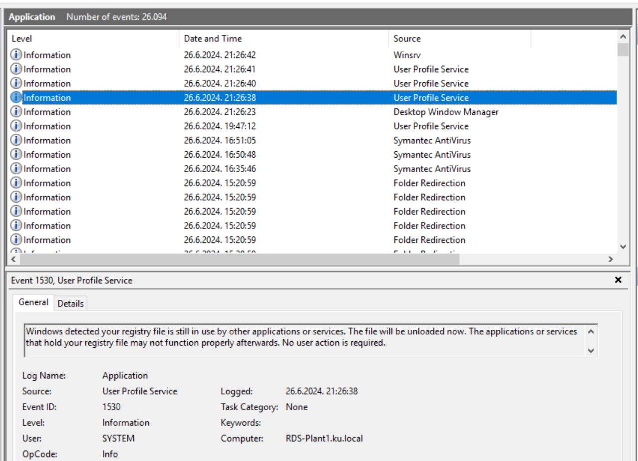

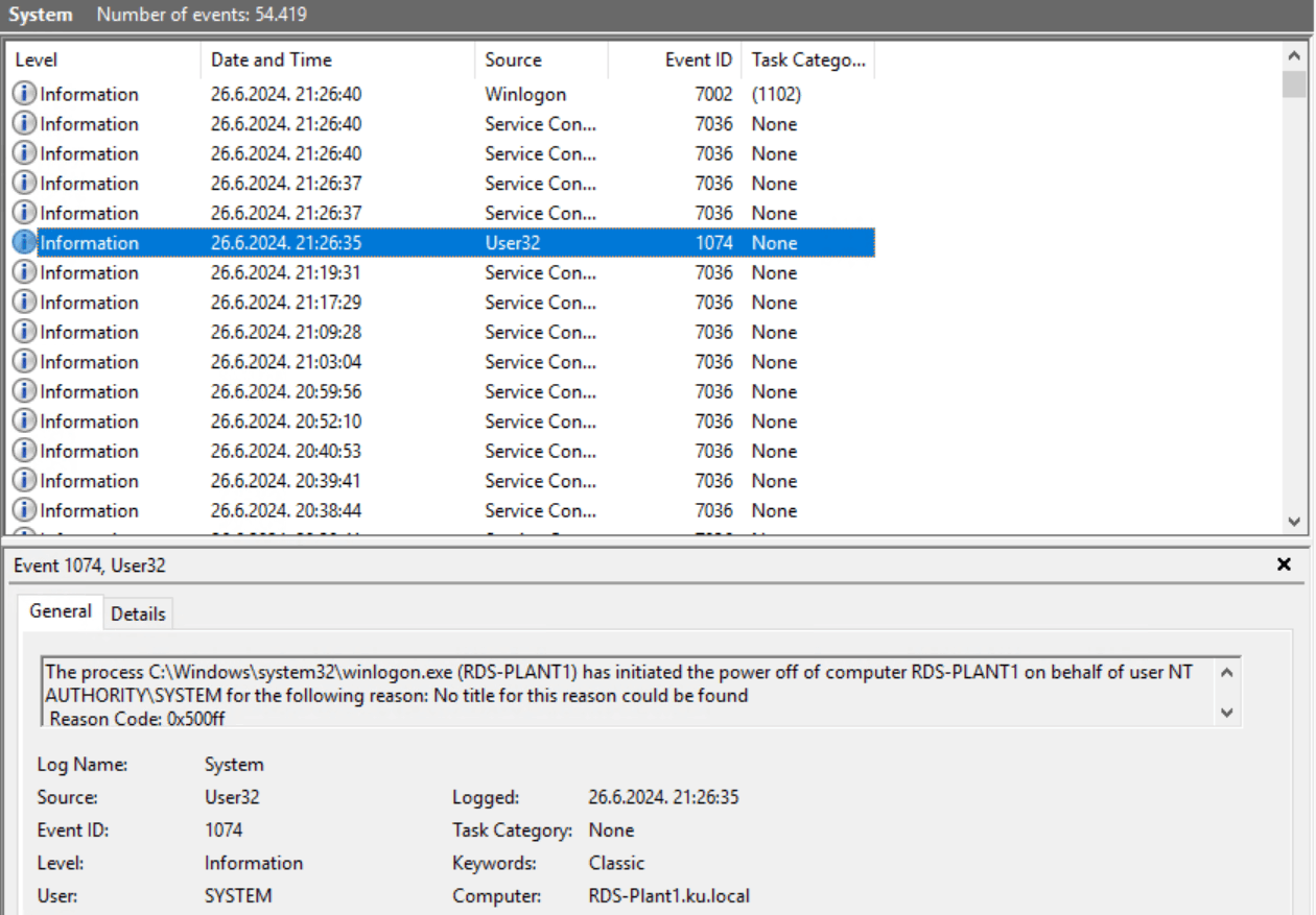

    I will once again checked Event log with the option "Show analytic and debug logs" turned on.
    The last shutdown happened yesterday at 21:26:35h and as you can see there is no error/warning before that event.
    In the Application log there is also nothing suspicious:
    Is there a way to turn on some debugging so that winlogon.exe writes some more information in the log about the reason why it requested power off?
