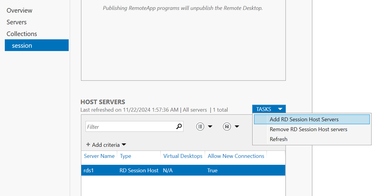

    I'm still a bit confused about the description of the issue. When you mentioned, "I'm trying to add these servers to the server farm I've setup, but the installation failed every time." are you referring to add servers to collections in RDCB (Remote Desktop Connection Broker)? If so, it sounds like you might be encountering permission issues within the RDS (Remote Desktop Services) environment.

    2024-11-22T06:04:37+00:00
    I've managed to get all the servers added to the RD Server farm. One problem solved.
    When I try to log in locally (console access) to the farm servers using the domain administrator account is when I get the restricted access problem.
