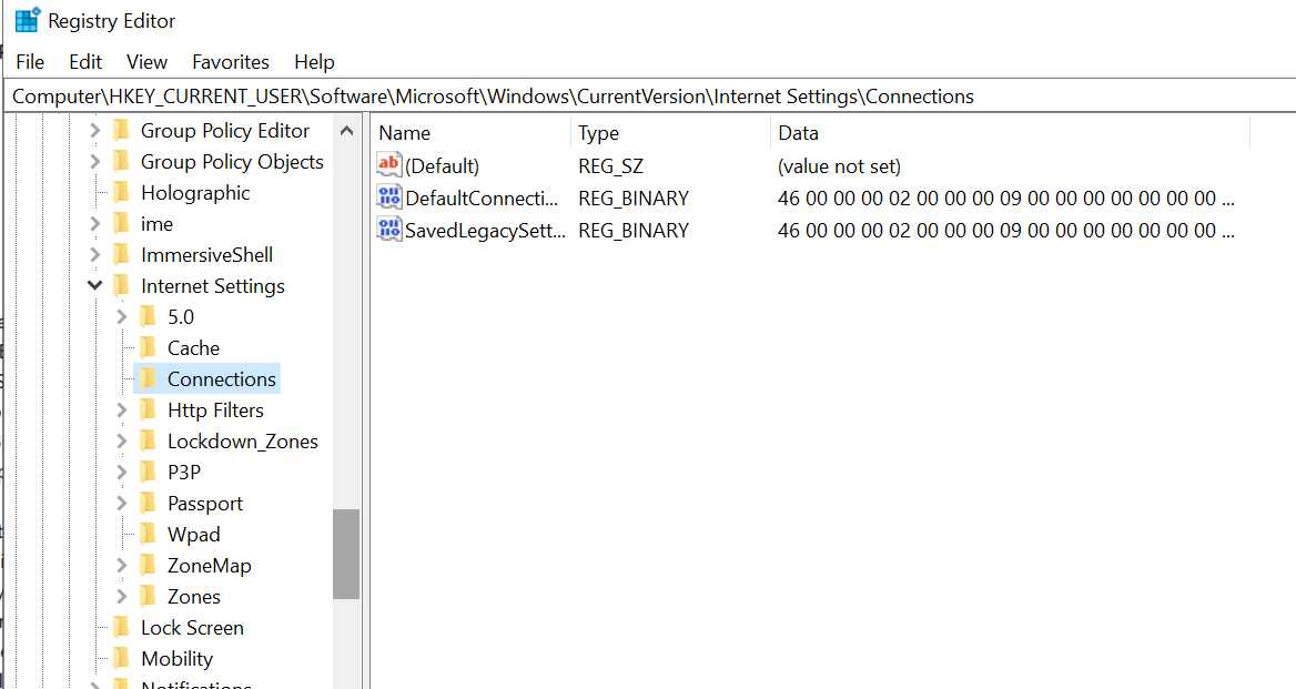

    1. Press Win + R to open the Run window, enter regedit and click OK to open the registry.
    2. Navigate to the following location: HKEY_CURRENT_USER \ SOFTWARE \ Microsoft \ Windows \ CurrentVersion \ Internet Settings \ Connections.
    3. Then delete the "Connections" item.
    1. Restart the computer.
    Note If you modify the registry incorrectly, you can cause serious problems. Therefore, follow these steps carefully. For additional protection, back up the registry before you modify it. For more information about how to back up and restore the registry, see How to back up and restore the registry in Windows.
